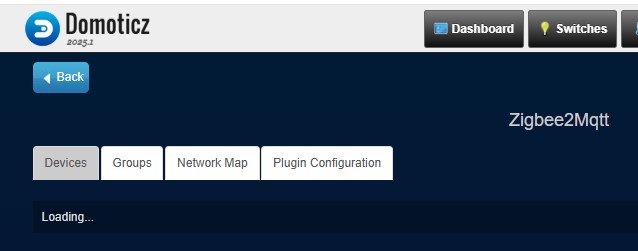

Does someone know why my Zigbee2Mqtt control panel does not loading?
I set the device "Zigbee 2MQTT API Transport" to used, but unfortunate the controlpanel stays in "loading" state

I Don''t think this is Zigbee2MQTT ?!
Maybe clear your browser cache
Also this is a very old topic

This is probably the zigbee2mqtt python plugin. You need to update the plugin as yours probably uses old API calls that have been deprecated in latest Domoticz stable.

I'v updated the zigbee2mqtt python plugin with "git pull". Unfortunately the Zigbee2mqtt control form still stay in loading state

Perhaps do a browser cache deletion or try Domoticz in a private/incognito browser session to emulate this.
Also restart Domoticz or the plugin...

Yeah...after deleting cookies and browserhistory. It's working ! Thanks a lot!
