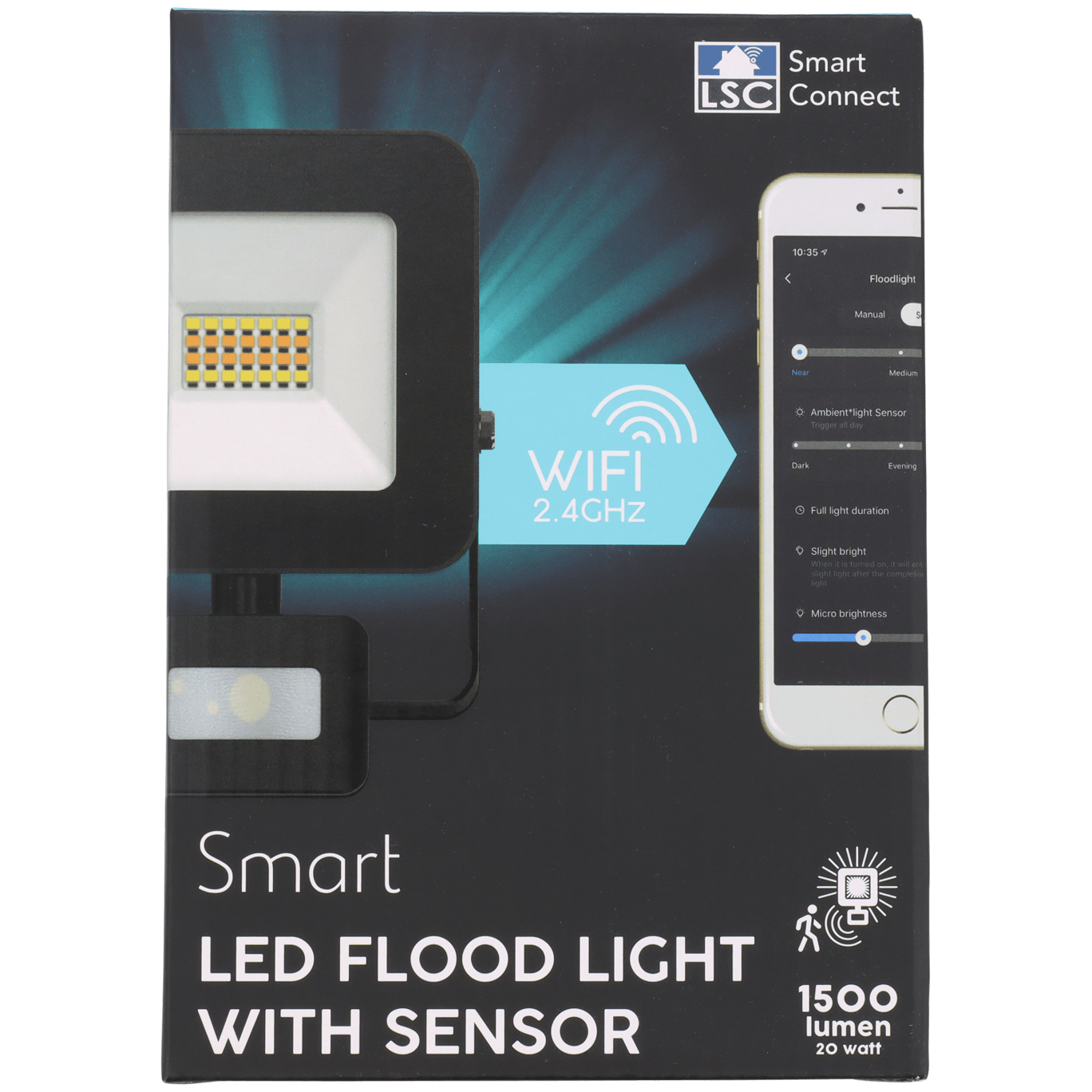

In the TuyaHA library there is nothing to find that a PIR is supported, sending mail is the only thing we can do. post

Hi,
I just bought this from action shop : https://www.action.com/fr-be/p/dummy-3003366/
https://www.action.com/globalassets/cms ... ImageLarge
I installed it trough the Tuya app.
It was discovered in my domoticz without any issue.
But the pir sensor is not detected.
Any idea if it can be added in domoticz ?
or if we can create a scenario if motion is detected then do something ?
or is it possible to detect the status of the lamp ?
I think that the on/off switch in domoticz can switch the ligh on/off in a manual mode.
in that mode, light stay just stay on.
If i go back to tuya app, i can set the motion mode, the it follow the "scenario" in the app ( switch on on motion, etc..)
Then i see that the switch stay on in domoticz.
I didn"t see any update in the domoticz logs .
Any idea if it's possible to enable the motion mode in domoticz and to get info when motion is detected ?
the goal is to switch other lamps when motion is detected.
Thx
