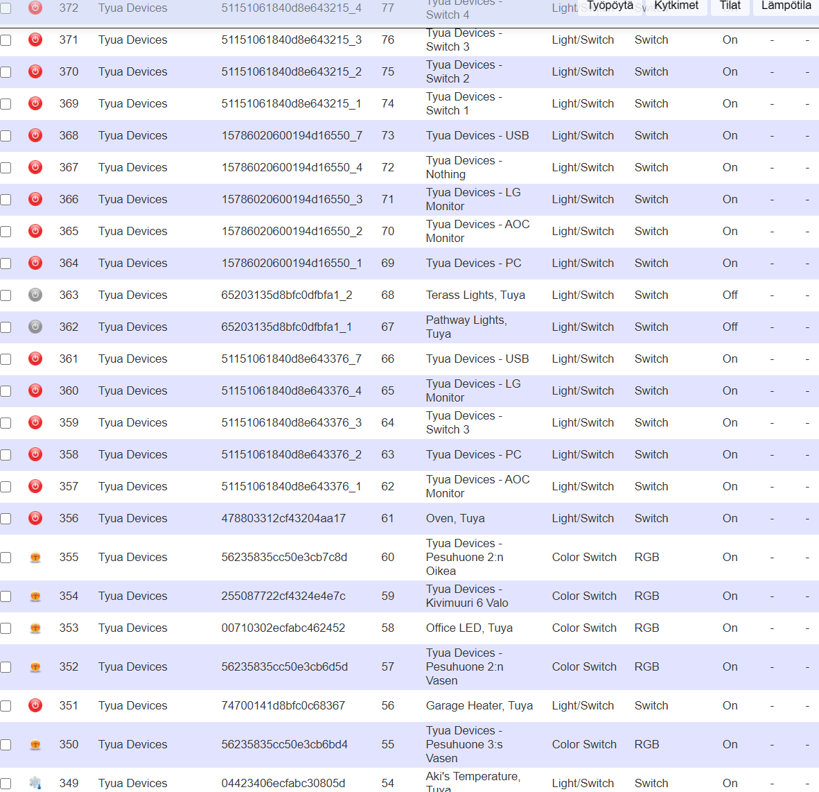

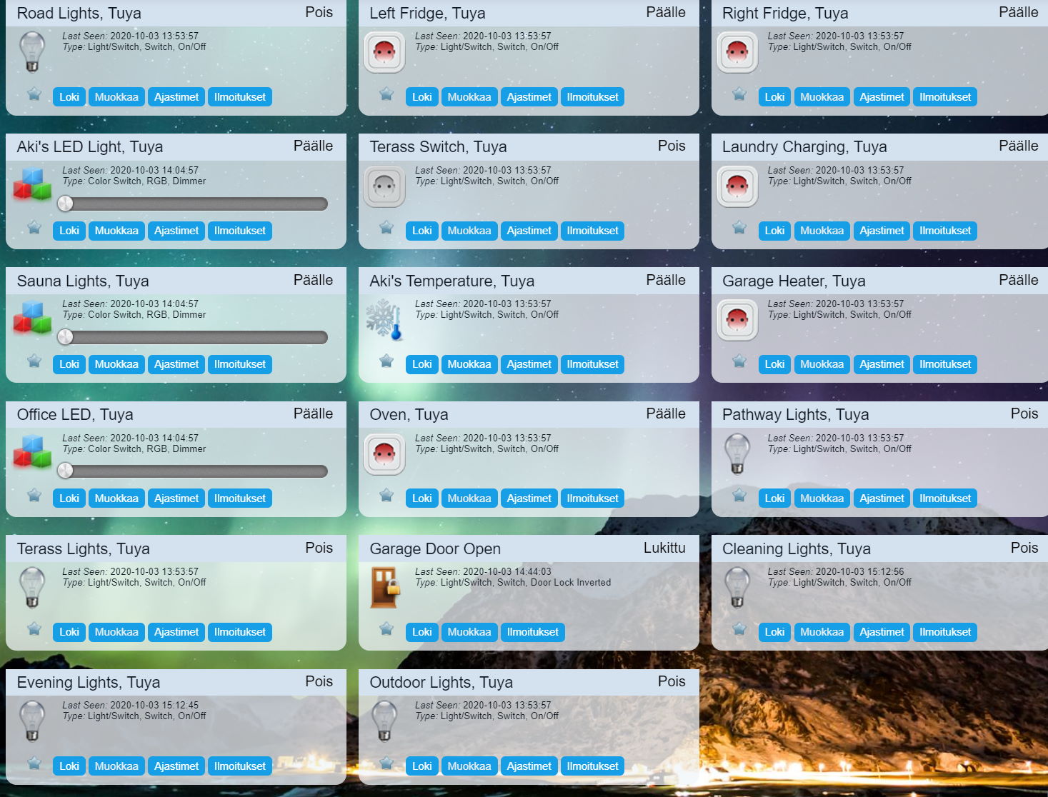

Has there been plans also to get the electricity consumption values of the plugs this plugin can switch on and off?
Also I can see this plugin recognized my Tuya thermostats but those does not show any temperature values.
But at the video is everything explained.
https://www.youtube.com/watch?v=pBJZcwIDOUY

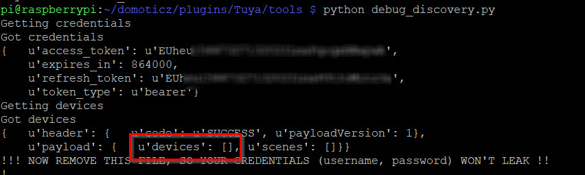

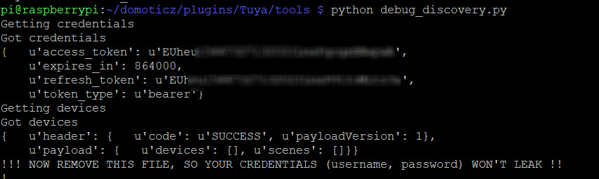

Last week I installed the Plugin in my Domoticz to control my smart Sockets, entered all the neccessary information on the hardware tab like username, password and country code.
But the only thing is I don't see any devices appearing in Domoticz.
I modified the debug_discovery.py script in the Tools directory with my settings and ran it. I don't see any error messages but to be honest I don't know how to read the message I receive.
Am I overseeing something?

There is nothing in the payload the devices section in empty. Do you used the corrected account?

I use the same account (E-mailaddress) and password which I use for access in the smartlife app

The builder of the tuyaha library as added this to the readme. The tuyaha library is the base Tuya plugin.
My device is not listed in Tuya API response or contains incomplete state, what should I do?
Write an email to [email protected] and mention the tuyapy library and https://px1.tuya{}.com API endpoint. Usually they ignore incoming emails, but perhaps, if they get a lot of emails, they will start fixing the API.

Thank you, I will send him / her an E-mail if feedback comes I will give an update.

Hi Xenomes, you mention that I need to write an E-mail to tuya and mention the tuyapy library and the https link!? Is that enough information?!
Or do I need to add additional information from these Smart Sockets? if that's the case what kind of information of the Sockect they need?
Many thanks in advance for your reply.

I tried today, but no succes with the LSC motion sensor from ActionMrRikkie wrote: Tuesday 21 July 2020 17:59 Hi, one question does this plugin also work for a motion detector ? I do not know how the app will register this, in principle it’s a switch.
If i run the debug_discovery it also noticed 0 devices ...

I wouldn't know either, I would mention brand and type of the device and the comment of PaulAnnekov.schijndela wrote: Friday 11 December 2020 16:45 Hi Xenomes, you mention that I need to write an E-mail to tuya and mention the tuyapy library and the https link!? Is that enough information?!
