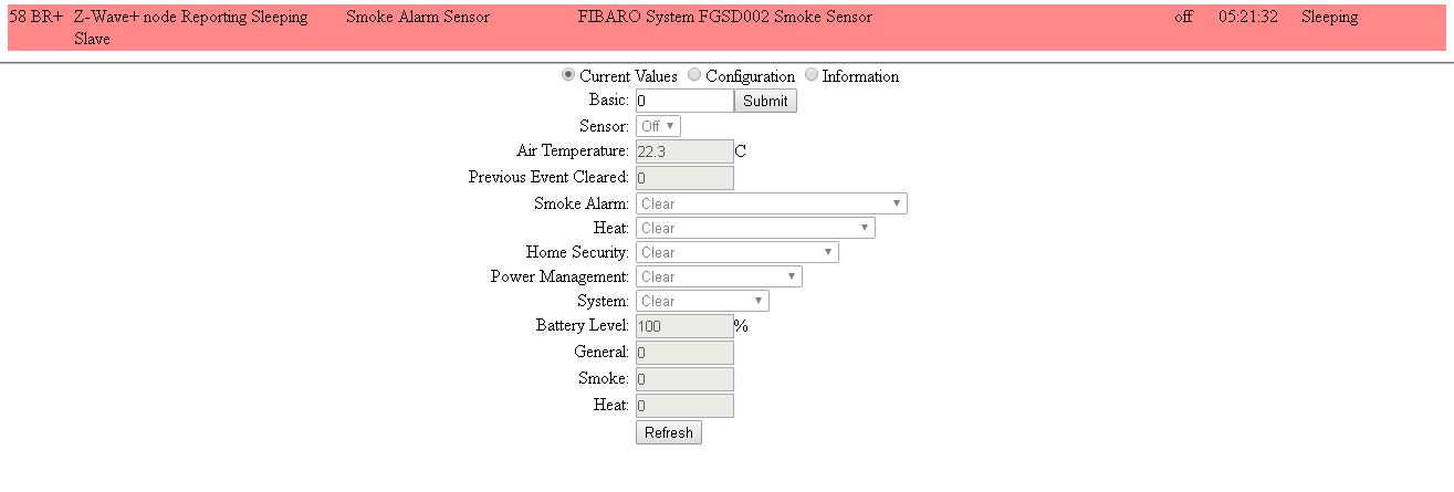

Fibaro Smoke Sensor2 (FGDS-002) not reporting temperature

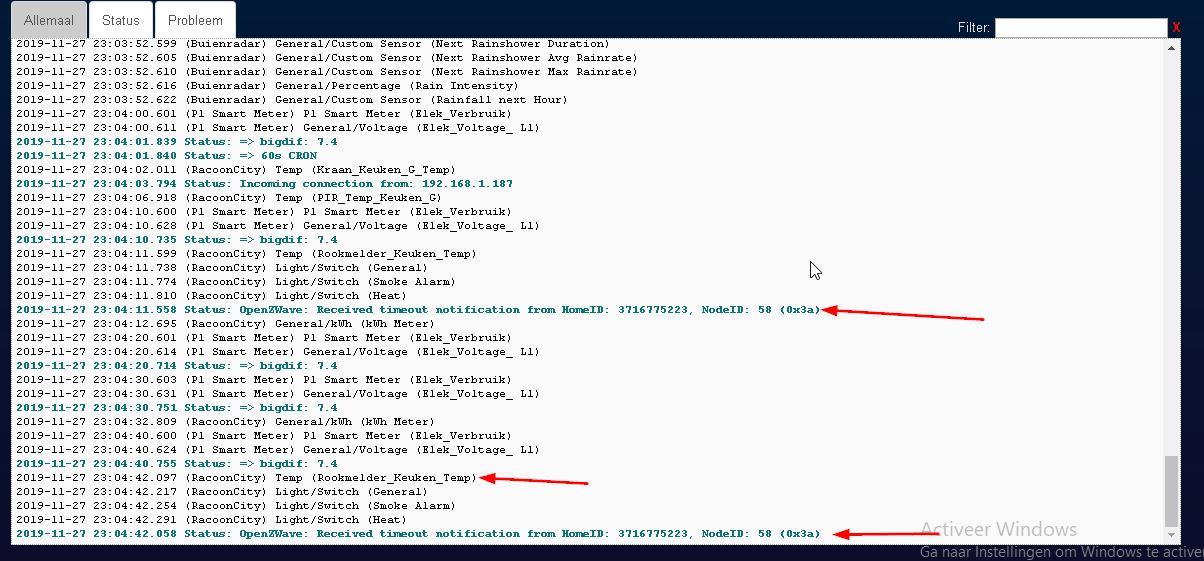

What i noticed in the OZW log output window when I wake up the device:
2019-11-26 20:56:46.904 Error, Node058, ERROR: Dropping command, expected response not received after 1 attempt(s)
2019-11-26 20:56:46.904 Always,
2019-11-26 20:56:46.904 Always, Dumping queued log messages
2019-11-26 20:56:46.904 Always, End of queued log message dump
2019-11-26 20:56:46.905 Always,
2019-11-26 20:57:14.083 Error, Node058, ERROR: Dropping command, expected response not received after 1 attempt(s)
2019-11-26 20:57:14.083 Always,
2019-11-26 20:57:14.083 Always, Dumping queued log messages
2019-11-26 20:57:14.083 Always, End of queued log message dump

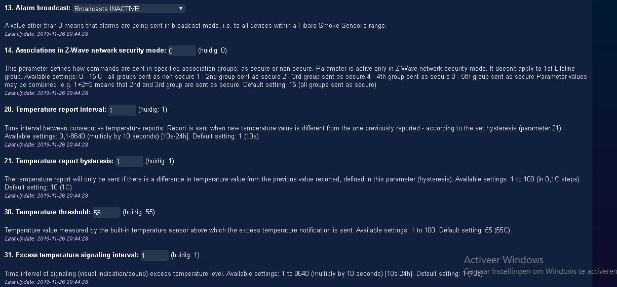

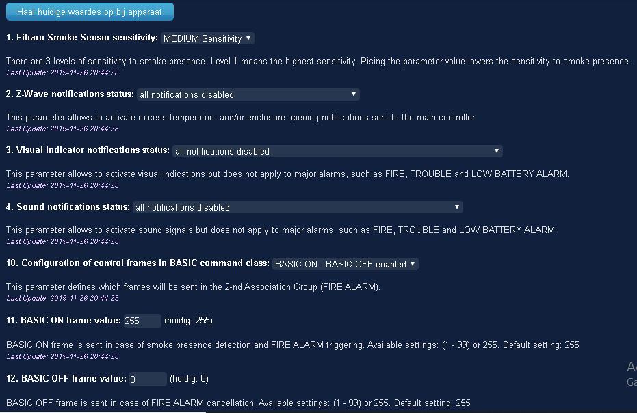

These are my settings for 1 module that is not reporting temperature:
What i find strange is that only group4 and group5 are 'linked' to my zwave controller.
Those are Fire and Smoke report.
Group1 is Lifeline and this is NOT linked to device1 (zwave controller)
And if i want to add it to device 1, it just does not show up.
Can you show me your settings of your device please and how are your groups configured for your Smoke SensorV2 ?
Thank you
Thank you

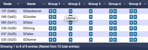

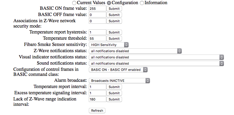

- Egregius
- Posts: 2592
- Domoticz version: v2024.7
- Location: Beitem, BE
Re: Fibaro Smoke Sensor2 (FGDS-002) not reporting temperature
These are my groups:
And the settings:
ropske
- Posts: 483
- Joined: Tuesday 12 August 2014 5:37
- Domoticz version: V3_8394
- Location: Rumbeke,Belgium
My settings are completely the same as yours.
Your 'Lifeline' group is linked to Group1
But mine not, i think that is the issue.
But the problem is that it won't accept it. When i enter Node1, it just won't show up.
