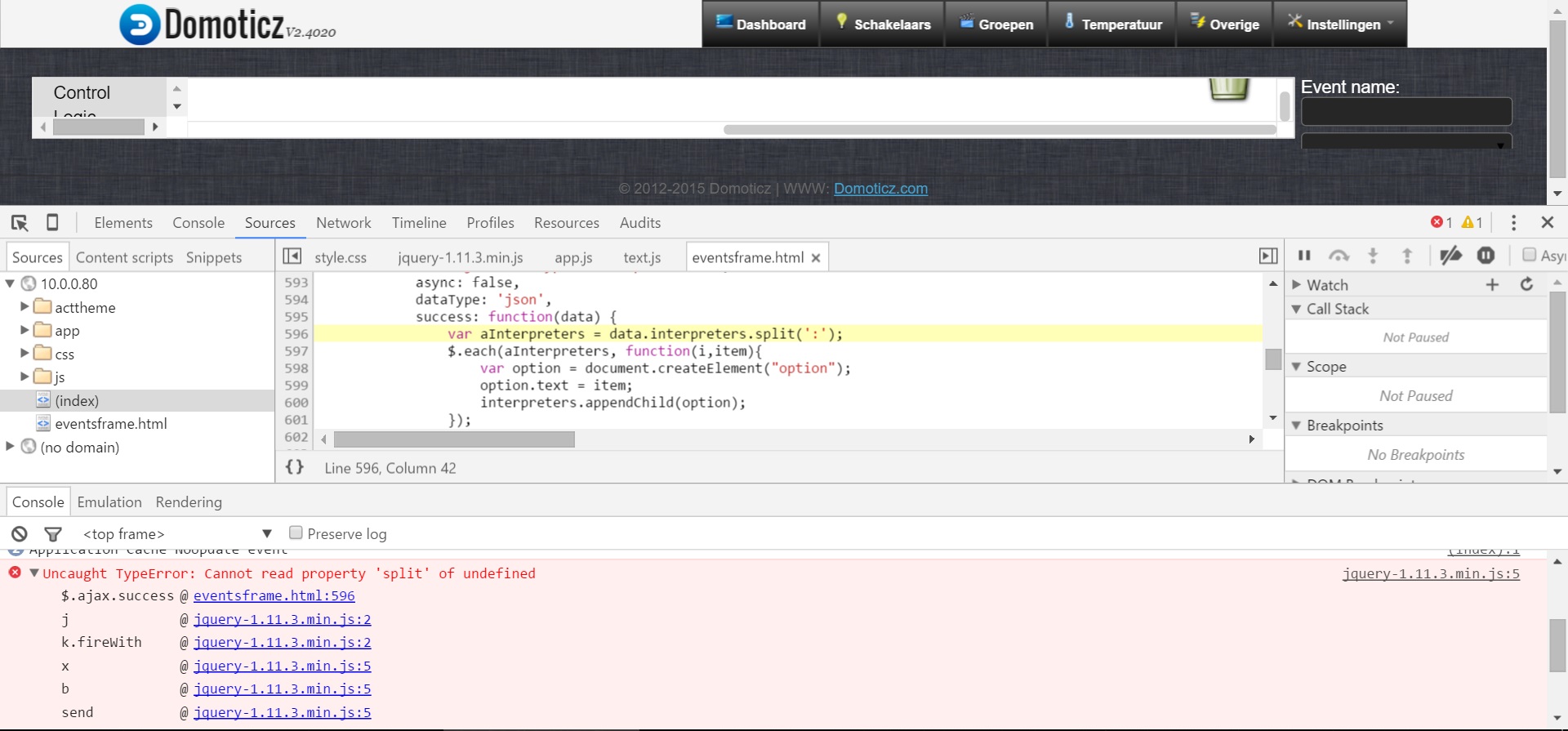

I still can't seem to get it working:
Schermopname (23).jpg (293.54 KiB) Viewed 4815 times
I have cleared the caches but that doesn't do anything.
The text.js error is gone though.
Edit: hmm.. I think tha DB update trigger did not fire correctly according to your information
Check the EventMaster table in the database, it should have new 'Interpreter' and 'Type' fields which would have been added during startup. The 'Interpreter' field should have defaulted to 'Blockly' and the 'Type' to 'All'.
I don't have those fields. I'll try and change the DB version to see if it will trigger the DB upgrade now
Edit2: I recompiled SQLHelper and now the DB is upgraded. No function of event screen still.

@bizziebis, sorry to hear you are still have issues. Great post BTW, makes troubleshooting much easier when I have the details.
From your screenshot I can see that you have the correct javascript and the text.js issue has gone so you have the correct version.
I believe the issue is on the back end because the existing code just drops through and returns "OK" but no data if it doesn't understand the command (I didn't change this in case something relies on the behaviour) and I think that is the case here. I think your domoticz.exe hasn't been rebuilt properly. The fact that you
at it fixed some things supports that.
I would recommend doing a full rebuild because SQLHelper was not the only file that changed, EventSystem did as well and I don't think you are running the new one.
Can you give that a go?

You are right. Don't know what was going on, but it seems other files were also not correctly compiled. Never had those issues before the boost upgrade. I hope it will not keep on happening in the future. It's a pain in the a** to debug this way.
But the editor is working now so I can give it a try!
