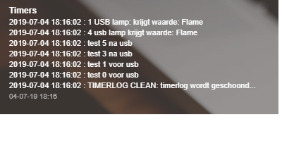

ok, that did not work even... my domoticz textfield gets extra linefeeds....
I have one config that both domoticz and dashticz are ok:
It works, so no need for digging :-)

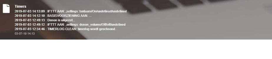

pvklink
Posts: 822
Joined: Wednesday 12 November 2014 15:01
Domoticz version: latest b
Re: need a loop for reading messages for logging
Post by pvklink »
Logging works OK!
I am rewriting all my scripts to use this..
Only with ifttt control var script i cant find why it is missing a value!
i renamed action to actionx because ifttt and globalmessage uses action
I think that it has something to do with global_data

pvklink
Posts: 822
Post by pvklink »
Yessssssssss, IFTTT now also works with the new logging...
Also made a script with a command to clean the log..
dz.devices('timerlog').updateText(dz.time.rawDate .. ' ' .. dz.time.rawTime .. ' :' .. ' TIMERLOG CLEAN: timerlog wordt geschoond...')
Or is it better to place this in your helper function ?
local function globalMessage(action, message )
if action == add then
messageTable = dz.helpers.addMessage(dz, item, info, message, messageTable )
elseif action == del then
dz.devices('timerlog').updateText(message)
dz.helpers.dumpMessages(dz, messageTable)
or even in the global_data ?
logging looks great!
looks great!

Nested script, messages lost
Post by pvklink »
Last problem, is a hard one.
I have nested scripts an both scripts uses the globamessages at their own and in combination.
When this test scripts calls the usb lamp, only the usb lamps logs are shown not 0-1-2 from the testscript and when i remark the usb lamp, i do get the 0-1-2 from the testscript/
I thought this was easy to fix by adding extra globalMessage() -- dump before calling the nested script so all the current logs where written...
but no !
    on = { devices = { 'test' }},
    execute = function(dz, item, info)
    local messageTable = {}
    local add = 'add'
    end        -- dz.devices('timerlog').updateText(dz.time.rawDate .. '  ' .. dz.time.rawTime .. ' : leeg')
        globalMessage(add, ' test 0 voor usb')
        --globalMessage() -- dump
        dz.devices('usb lamp').switchSelector(40)   -- the script for usb lamp also writes to the log !!!when is is not remarked out the other logs are not visible
        --dz.devices('Bewegingsservice').switchOff()
        globalMessage(add, ' test 1 na usb')
        globalMessage(add, ' test 2 na usb')
Jablotron connection, Ikea
Re: Nested script, messages lost
pvklink wrote: Thursday 04 July 2019 10:03 Last problem, is a hard one.
There is no such thing as nested scripts in the domoticz Eventsystem.
The Eventsystem is single threaded meaning that a script needs to be finished before a next script can start.
pvklink
Posts: 822
Post by pvklink »
mmm,strange my testscript writes log messages ok when activate test and disabling the usb lamp that is calling its own script also with log messages...
but when enabling the usb lamp in the test script, the test logs get lost and only the usb lamp one appear
see the test script above...
pvklink wrote: Thursday 04 July 2019 15:37 mmm,strange my testscript writes log messages ok when activate test and disabling the usb lamp that is calling its own script also with log messages...
Probably because they both use the same domoticz object so there 'currenttext' is the same for both. A way to prevent this type of conflict is to get 'currenttext' from a variable in global data and not from the text device.
pvklink
Posts: 822
Post by pvklink »
Got it working! THANKS again @WAAREN
The usb logging is showing up now!
Strange thing is that the USB logs are logged later!
1. is this a good way to add the delete function ? it is working...
2. do i need the dz parameter in
globalMessage(dz,del, dz.time.rawDate .. ' ' .. dz.time.rawTime .. ' :' .. ' TIMERLOG CLEAN: timerlog wordt geschoond...') -- delete
3. last thing is to add logcode 1,2,3 to addMessage to 1= log domoticz.log, 2= log global, 3 log both
then time for a holiday and no more scripting. I can check remote (via logs) if everything works ok!
my test script
    local logcode = 3
    local add = 'add'
    local del = 'del'
    local chg = 'chg'
    local function globalMessage(dz, action, message, logcode)
        if logcode == nil then logcode = 3 end
        if action == add and logcode > 0 then
            messageTable = dz.helpers.addMessage(dz, item, info, message, messageTable, logcode)
            dz.globalData.mylogging = message
        elseif action == chg then
        --globalMessage(dz,del, dz.time.rawDate .. '  ' .. dz.time.rawTime .. ' :' .. ' TIMERLOG CLEAN: timerlog wordt geschoond...') -- delete
        globalMessage(dz,del, dz.time.rawDate .. '  ' .. dz.time.rawTime .. ' :' .. ' TIMERLOG CLEAN: timerlog wordt geschoond...' .. '<br>') -- delete
        globalMessage(dz,add, ' test 0 voor usb',1)
        globalMessage(dz,add, ' test 1 voor usb',1)
        globalMessage(dz,add, ' test 2 na usb',0)
        globalMessage(dz,add, ' test 3 na usb',0)
        globalMessage(dz,add, ' test 4 na usb',3)
        globalMessage(dz,add, ' test 5 na usb',0)
        globalMessage(dz,add, ' test 6 na usb',logcode)
        globalMessage(dz,chg) -- dump

Busy with the last part.
want to call the logfunctie with the logcode: 0 no log, 1 = domoticz log, 2 = global var log, 3 = all
0 and 3 works ok!
globalMessage(add, ' BASISVOORZIENING AAN: ...',1)
this is the function:
    local logcode = 3
    local add = 'add'
    local del = 'del'
    local chg = 'chg'
    local function globalMessage(action, message, logcode)
logcode = 0 is working ok.
