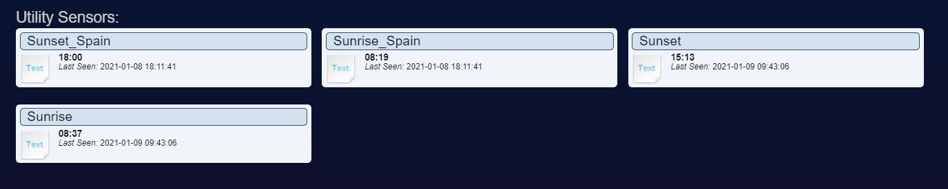

Hallo Warren, first many thanks for all code you have given us!! dzvents is a reel blessing for an amateur like me!!
The script you given us in this tread I would like to use in a slightly different scenario!
I want to control the lights in two different places, they obviously then have different sunset / sunrise. This means that Domoticz location is not enough.
I therefore tried to manipulate your script but cant solve all :-( so if you have time to guide me I would be great full.
The script as is works but I would like if possible to do one out of two modifications:
1: best (fantastic) would be if the created new Sunset_Spain and Sunrise_Spain could be used in the same way as dzvents sunset / sunrise. I realise that it is to ask to much but have to ask ;-)
2: second best would be if it could be changed so that instead of (or both) updating a text object it would turn ON a switch at the time fetched for sunrise / sunset. I'm thinking that I create two dummy switches for sunset/sunrise and then the script do something like "sunrise.switchOn().afterMin("fetchedtime-now")" well the result would be that a switch turns on at sunrise and another at sunset. This two could then be used to trigger scripts for my second location.

Well worth a try anyhow, now I'm running two instances of Domoticz and hoped to reduce that to one :-)
/lennart
Re: Begin- and endTime of some astro events
leby wrote: Friday 08 January 2021 14:29 best (fantastic) would be if the created new Sunset_Spain and Sunrise_Spain could be used in the same way as dzvents sunset / sunrise.
Can you try this one ?

:) Absolutely what can I expect? Should I try to use "Sunset_Spain" as a global variable the same way I use sunset??
Just for info:
I run the script and get this in the logg:
2021-01-08 18:11:40.629 Status: EventSystem: Script event triggered: /home/pi/domoticz/dzVents/runtime/dzVents.lua
2021-01-08 18:11:41.526 Status: dzVents: Info: Handling httpResponse-events for: "astro dzVentsSpain"
2021-01-08 18:11:41.527 Status: dzVents: Info: astro dzVents: ------ Start internal script: Test sunset sunrise: HTTPResponse: "astro dzVentsSpain"
2021-01-08 18:11:41.529 Status: dzVents: > nautical_twilight_end: 2021-01-08T18:02:07+00:00
2021-01-08 18:11:41.529 Status: dzVents: > civil_twilight_end: 2021-01-08T17:29:24+00:00
2021-01-08 18:11:41.529 Status: dzVents: > astronomical_twilight_end: 2021-01-08T18:33:57+00:00
2021-01-08 18:11:41.529 Status: dzVents: > sunset: 2021-01-08T17:00:22+00:00
2021-01-08 18:11:41.529 Status: dzVents: > civil_twilight_begin: 2021-01-08T06:50:09+00:00
2021-01-08 18:11:41.529 Status: dzVents: > nautical_twilight_begin: 2021-01-08T06:17:26+00:00
2021-01-08 18:11:41.529 Status: dzVents: > solar_noon: 2021-01-08T12:09:46+00:00
2021-01-08 18:11:41.529 Status: dzVents: > astronomical_twilight_begin: 2021-01-08T05:45:36+00:00
2021-01-08 18:11:41.529 Status: dzVents: > day_length: 34872
2021-01-08 18:11:41.529 Status: dzVents: > sunrise: 2021-01-08T07:19:10+00:00
2021-01-08 18:11:41.559 Status: dzVents: Debug: astro dzVents: Processing device-adapter for Sunset_Spain: Text device
2021-01-08 18:11:41.562 Status: dzVents: Debug: astro dzVents: Processing device-adapter for Sunrise_Spain: Text device
2021-01-08 18:11:41.562 Status: dzVents: Info: astro dzVents: ------ Finished Test sunset sunrise
Don't know if it is correct or not..
leby wrote: Friday 08 January 2021 17:54 :) Absolutely what can I expect? Should I try to use "Sunset_Spain" as a global variable the same way I use sunset??
Looks OK to me. You should see the sunset and sunrise times in the text devices you created for it.

waaren wrote: Friday 08 January 2021 18:23 Looks OK to me. You should see the sunset and sunrise times in the text devices you created for it.
Ok, sorry I'm not native English speaking so perhaps it was unclear.
The script worked before and updated the text objects. What I tried to ask about was this below:
Perhaps you last script will update a device, now I did se this code:
elseif item.isTimer or item.isDevice then
I will let it run a day and that should give me the answer I guess

Would it be possible to add an offset in minutes to the time the "customEvent" triggers?
This should do that
-- collect begin- and endtimes of some astro events. dzVents >= 3.0
local scriptVar = 'astro dzVents'
return
    on =
        timer =  -- twice a day to be sure and 3 min past the hour because at the hour already quite busy
            'at 00:03',
            'at 06:03'
        devices =
            'astroTrigger', -- Just for test / development. Can be ignored.
        httpResponses =
            scriptVar .. '*',
    logging =
        level = domoticz.LOG_DEBUG, -- set to domoticz.LOG_ERROR when all OK
        marker = scriptVar,
    execute = function(dz, item)
        local latSpain = 38.129097 -- optional
        local lonSpain = -0.692064 -- optional
        -- domoticz text devices. Comment lines for devices or remove them if you don't have / want
        local devKeys =
        {   -- Device names                  -- Key  in data             defaults
            ['Civil Twilight End']          = 'civil_twilight_end',
            ['Civil Twilight Start']        = 'civil_twilight_begin',
            ['Nautical Twilight End']       = 'nautical_twilight_begin',
            ['Nautical Twilight Start']     = 'nautical_twilight_end',
            ['Astronomical Twilight End']   = 'astronomical_twilight_begin',
            ['Astronomical Twilight Start'] = 'astronomical_twilight_end',
            ['Sunset']                      = 'sunset',
            ['Sunrise']                     = 'sunrise',
        -- customEvent triggers
        local customEventKeys =
        { --  device             key       offset
            ['Sunset_Spain'] = { 'sunset', -30 },
            ['Sunrise_Spain'] = { 'sunrise', 45 },
        local function TZOffset()  -- in seconds
            return os.difftime(os.time(), os.time(os.date('!*t'))) + (dz.time.isdst and 3600 or 0)
        local function makeTime(str, offset)
            local offset = offset or 0
            local pattern = '(%d+)-(%d+)-(%d+)T(%d+):(%d+):(%d+)'
            local runyear, runmonth, runday, runhour, runminute, runseconds = str:match(pattern)
            local timestamp = os.time({year = runyear, month = runmonth, day = runday, hour = runhour, min = runminute + offset, sec = runseconds})
            return (os.date('%X',timestamp + TZOffset())):sub(1,5)
        local function getAstroData(lat, lon, other, delay)
            local other = other or ''
            url = 'https://api.sunrise-sunset.org/json' ..
                            '?lat=' .. (lat or dz.settings.location.latitude) ..
                            '&lng=' .. (lon or dz.settings.location.longitude) ..
                            '&formatted=0'
                dz.openURL(
                    url = url,
                    callback = scriptVar  .. other
                }).afterSec(delay or 0)
        local function procesResults(t, location)
            location, _ = location:gsub(scriptVar,'')
            if location ~= '' then
                for trigger, field in pairs(customEventKeys) do
                    if t[field[1]] then
                        dz.log('dz.emitEvent(' .. trigger .. ').at(' .. makeTime(t[field[1]],field[2]) .. ')',dz.LOG_DEBUG )
                        dz.emitEvent(trigger).at(makeTime(t[field[1]],field[2]))
                for dv, field in pairs(devKeys) do
                    if dz.devices(dv) and t[field] then
                        dz.devices(dv).updateText(makeTime(t[field]))
        if item.isHTTPResponse and item.json then
            procesResults(item.json.results, item.trigger)
            getAstroData()
            getAstroData(latSpain,lonSpain, 'Spain', 5) -- optional other location
            dz.log('problem retrieving information from sunrise-sunset.org for ' .. item.trigger:gsub(scriptVar,''), dz.LOG_ERROR)
            dz.log(item,dz.LOG_DEBUG)
