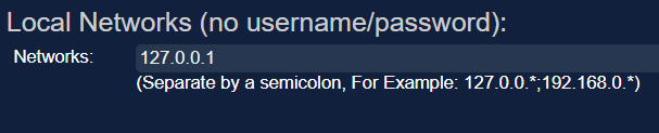

Re: Begin- and endTime of some astro events
Jubbes wrote: Sunday 31 May 2020 20:50 The times in the dashboard are correct
You probably have not met this requirement yet.
Also make sure that in the Security section in the settings you allow 127.0.0.1 to not need a password. dzVents uses that port to send certain commands to Domoticz.
Jubbes
Posts: 33
Joined: Wednesday 24 October 2018 14:35
Post by Jubbes »
2020-05-31 21:44:00.652 Status: dzVents: > serverPort: 8080
2020-05-31 21:44:00.652 Status: dzVents: > Domoticz url: http://127.0.0.1:8080
2020-05-31 21:44:00.652 Status: dzVents: > location:
2020-05-31 21:44:00.652 Status: dzVents: > latitude: 50.758067
2020-05-31 21:44:00.652 Status: dzVents: > longitude: 6.840787
2020-05-31 21:44:00.652 Status: dzVents: > name: Domoticz
2020-05-31 21:44:00.652 Status: dzVents: > webRoot:
2020-05-31 21:44:00.653 Status: dzVents: > domoticzVersion: 2020.2
2020-05-31 21:44:00.653 Status: dzVents: > Log level: 1
2020-05-31 21:44:00.653 Status: dzVents: > dzVentsVersion: 3.0.2
2020-05-31 21:44:02.247 Status: dzVents: > webRoot:
2020-05-31 21:44:02.247 Status: dzVents: > serverPort: 8080
2020-05-31 21:44:02.247 Status: dzVents: > Domoticz url: http://127.0.0.1:8080
2020-05-31 21:44:02.247 Status: dzVents: > dzVentsVersion: 3.0.2
2020-05-31 21:44:02.248 Status: dzVents: > location:
2020-05-31 21:44:02.248 Status: dzVents: > name: Domoticz
2020-05-31 21:44:02.248 Status: dzVents: > latitude: 50.758067
2020-05-31 21:44:02.248 Status: dzVents: > longitude: 6.840787
2020-05-31 21:44:02.248 Status: dzVents: > domoticzVersion: 2020.2
2020-05-31 21:44:02.248 Status: dzVents: > Log level: 1
Jubbes
Posts: 33
Re: Begin- and endTime of some astro events  [SOLVED]
Post by Jubbes »
That it was waaren. Thank you very much.
