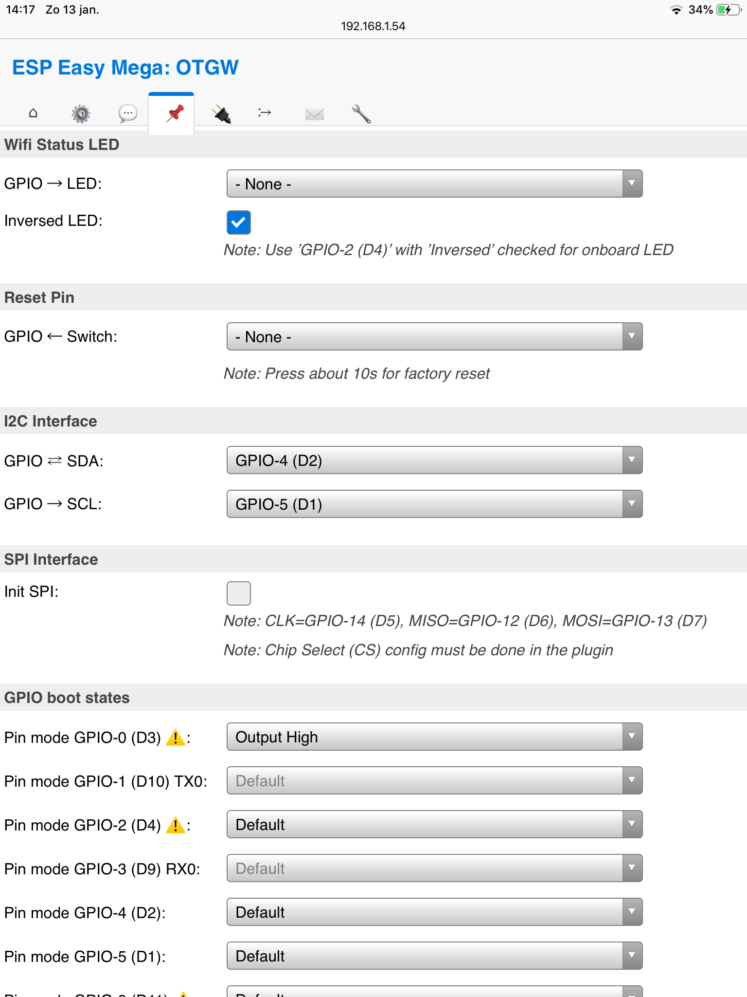

How does your hardware settings look like?

I only changed the GPIO-0 becouse it resets the opentherm gateway at reboot. No other settings than default
