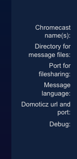

A new field has been added "Domoticz url and port:" you need to fill this in. ie http://xxx.xxx.xxx.xxx:8080

Re: Python Plugin: Chromecast
Posted: Sunday 25 November 2018 10:09
by bramski
Thanks for the plugin. I was also struggling to get it up and running.
For everyone having the list index errors please try the following.
- Ssh into your domoticz instance
- Execute `curl http://127.0.0.1:8080/json.htm`
When you get a 401 unauthorized, this is your problem. This means your domoticz instance cannot access the API without a username/password.
You can set this up in "Setup" -> "Local networks". Make sure you add 127.0.0.* there.
Try again using the the curl command. If you get a JSON response you can re-enable the chromecast plugin and it should start creating devices.
