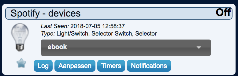

After re-init the code something is happening. I get a device, but only one ...
Screen Shot 2018-07-05 at 13.00.14.png (51.43 KiB) Viewed 6704 times
I expected more controls ???

Sjaakios
Posts: 37
Joined: Saturday 04 June 2016 23:41
Re: Python Plugin: Spotify
Post by Sjaakios »
Cool! I'll fix that in the code... [update]fixed in new version[/update]
For the usage, now update your user variable Spotify-searchTxt with for instance 'artist coldplay'. After the update. select on the device ebook, it should start playing spotify on this device.
