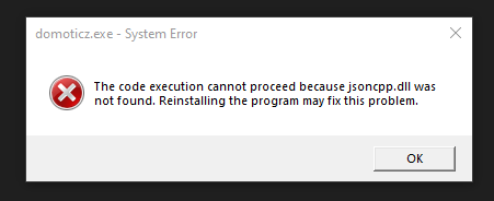

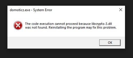

After one year, I have problem again :(
When I try run domoticz on VS2022, i get errors like:
I see this files in user/source/repos/vcpkg/....
EDIT: Resolved. I I forgot about win32
