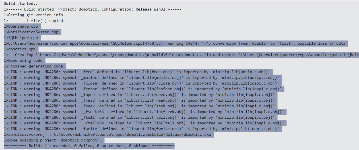

o Right click the domoticz project and choose build to build the project. Building ends for me with these lines in the Visual Studio output view
1>   Creating library C:\Users\<username>\source\repos\domoticz\msbuild\Debug\domoticz.lib and object C:\Users\<username>\source\repos\domoticz\msbuild\Debug\domoticz.exp
1>domoticz.vcxproj -> C:\Users\<username>\source\repos\domoticz\msbuild\Debug\domoticz.exe
1>C:\Users\<username>\source\repos\domoticz\msbuild\Windows Libraries\openzwave\OpenZWave.dll
1>C:\Users\<username>\source\repos\domoticz\msbuild\Windows Libraries\openzwave\OpenZWaved.dll
1>        2 file(s) copied.
1>Done building project "domoticz.vcxproj".
========== Build: 1 succeeded, 0 failed, 0 up-to-date, 0 skipped ==========

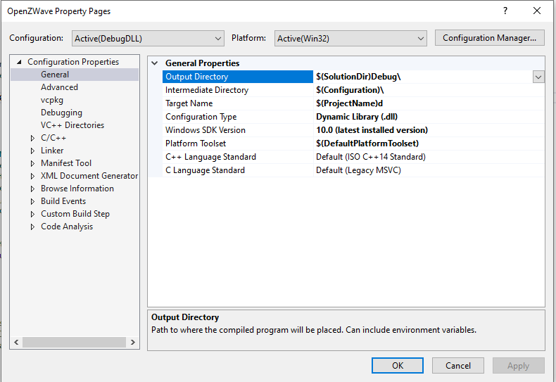

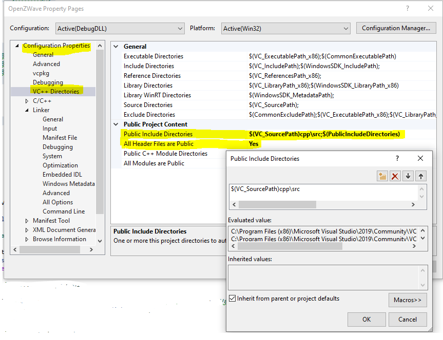

To enable debugging of domoticz together with openzwave, you can add the openzwave project into the domoticz solution by following the next steps. The same settings can't be used to build the release version, but a release version of the both targets can still be built using the existing cmake build process, this is just to create a debugging environment for the both projects together.
The instructions earlier in this thread describe downloading and extracting the WindowsLibraries 7z file to get all required dependencies to build domoticz. Most of these dependencies are -apart from openzwave- however already also available from the steps installing and running vcpkg. If you want to rebuild the exact same version as the -official- domoticz, please make sure you use the include and library files included in the 7z file. If however you want to use the latest versions of all dependencies, skip the steps with the 7z file and use the headers and libraries provided by the vcpkg procedure. I build my domoticz against the latest dependencies provided by vcpkg, so I did not extract the windowsLibraries 7z. You may have to play around a little with the include paths and the libraries to link to to get it working as you will see further on. Hint: errors compiling ozwcp.cpp are often caused by including python's node.h instead of openzwave's node.h.
We will include the both projects domoticz and openzwave in one solution. Although not required I suggest to pull the both projects into 2 folders based of the same path to make it easy to create the references. In my case I used E:\Github\domoticz as the base folder for both projects (I use domoticz' fork of the openzwave project). So my domoticz source files are in E:\Github\domoticz\domoticz and my openzwave source files are in E:\Github\domoticz\open-zwave.

  • The OpenZWave project needs a few settings changed to build correctly. So we locate in the solution explorer window the entry "OpenZWave" and right-click it. From the menu select "Properties".
  • In the left pane select "Configuration Properties" -> "General". Then in the right pane, change "Output Directory" into "$(SolutionDir)Debug\". This will make sure both the dll and the libraries will be available to build and later run domoticz.exe.
    openzwave properties.PNG (28.81 KiB) Viewed 5982 times
  • Next we need to make sure the proper include files are found when building domoticz: In the Solution Explorer window locate and right click the "OpenZWave" project entry. From the menu select "Properties...".
  • In the left pane select "Configuration Properties" -> "VC++ Directories". Then in the right pane locate "Public Include Directories". Add the text "$(VC_SourcePath)cpp\src" as the 1st entry in the list. (Use the button in the right of the field to open an edit window, there use the Add entry button to add a new entry, then locate and add the path). In my case this adds "E:\Github\domoticz\open-zwave\cpp\src". Then click the "OK" button to close the edit window. Next also change the entry for "All Header Files are Public" to "Yes". And then again click the "OK" button to save the settings.
    openzwave vc++ directories.PNG (54.9 KiB) Viewed 5982 times
