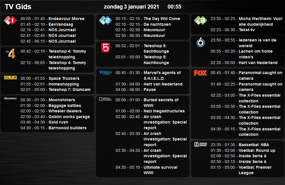

Re: Dashticz - Module - Tv Guide (Dutch)
Posted: Sunday 03 January 2021 1:07
by HansieNL
Thanks again. This is my TV Guide now...
These are the codes used... And used my own images ofcourse.
Posted: Sunday 03 January 2021 23:34
by hsvt
HansieNL wrote: Sunday 03 January 2021 1:07 Thanks again. This is my TV Guide now...
I can't see the image. (Also not in the PM you sent)
Posted: Sunday 03 January 2021 23:41
by HansieNL
hsvt wrote: Sunday 03 January 2021 23:34
Mmm... I just tried 3 browsers on iPad without a problem. Tried also a private browser. It has a http link and no https. I don’t know if something is blocking it from viewing at your side.
@hsvt Dan zou deze wel zichtbaar moeten zijn...
