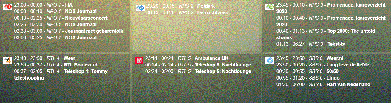

HansieNL
Posts: 994
Re: Dashticz - Module - Tv Guide (Dutch)
Post by HansieNL »
Thanks again. This is my TV Guide now...
These are the codes used... And used my own images ofcourse.

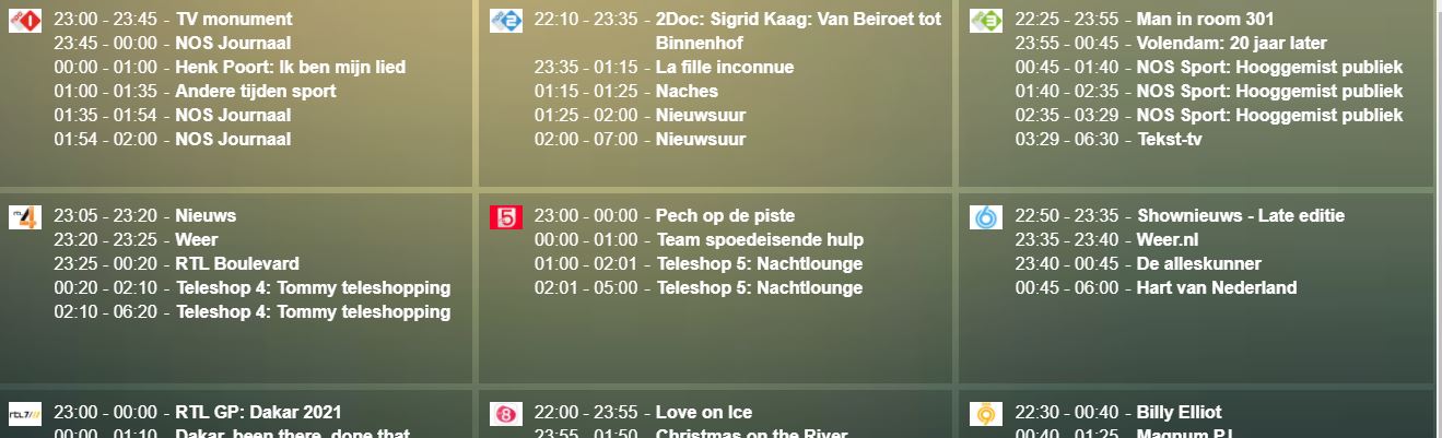

Yes, it works.
Solution in excact 24 hour. :o
hsvt wrote: Saturday 02 January 2021 0:02
Lokonli wrote: Sunday 03 January 2021 0:02
Thanks for it.
Only put "layout: 1" into each line.
The most time it was to find out how to get the beta version. :lol:
But this is how my TV-guide looks now.
tv gids.JPG (94.03 KiB) Viewed 1697 times
