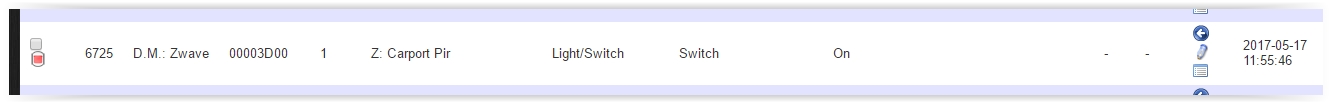

Derik
Posts: 1605
Re: Python plugin: Battery Level for Z-Wave Devices
Post by Derik »
Perhaps something strange:
Logread
Posts: 229
Joined: Sunday 28 August 2016 7:48
Location: France
Post by Logread »
Derik wrote:Perhaps something strange
Did you check in the settings/devices list to see if the same 104% battery level value appears ? The plugin gets the data from there (it would be better to get it directly from openzwave for sure, but could be for a future version if I find the time or help to understand how to install and use the openzwave-python API for this.

LouiS22
Posts: 433
Location: Budapest, Hungary
Post by LouiS22 »
I've seen this on cheap chinese z-wave stuff, maybe a bad implementation of the battery reading routine.
Logread
