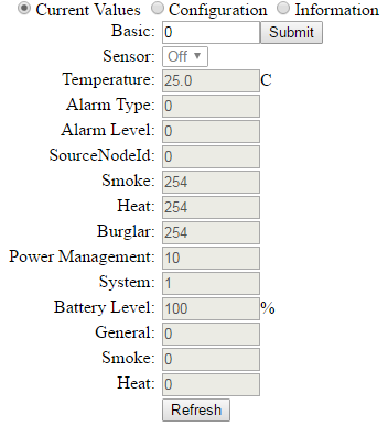

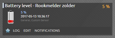

I have 3 smoke sensors Fibaro FGSD002. I replaced a battery of one of these smoke sensors yesterday (after installing the plugin), but the sensor still shows 5% battery.
But the Openzwave panel shows that the battery is 100%.
The wakeup interval of the smoke sensor is 6 hours and the battery is in there for at least 12 hours now.
One of the smoke sensor devices in the Devices list shows indeed a battery level of 5%.
How does the script check the value for the battery? Does it use one of the devices or does it use the value the Openzwave config is showing?
Not using Domoticz anymore

I can also give some examples:
Fibaro SD1 & 2: 100% in DZ, 0% in OZWCP (but still working)
Fibaro SD3, 4 & 5: 100% in DZ, 100% in OZWCP (not possible after more than a month)
Fibaro SD6: No report in DZ, 100% in OZWCP (not possible after several months)
Fibaro Motion sensors all report 100% battery :?
The door contacts are the worst, I think that's mainly because they have a default wake up interval that's so long it never happens (should change that once...)

Just looked at the new devices, some are marked red, probably because they haven't updated in the last 720 minutes (sensor timeout in settings).
Didn't look at the code yet how often this is executed but maybe not a bad idea to update the sensors every x hours to avoid this?
