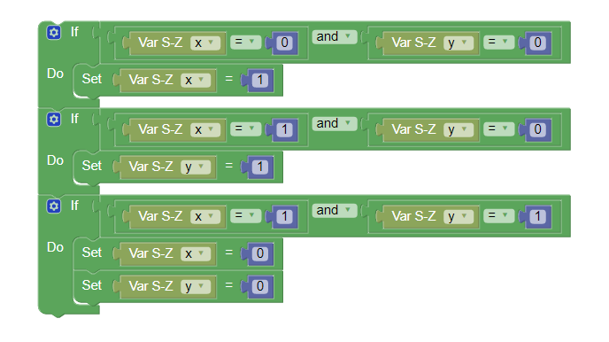

Like Spitfire and others stated before else-if logic is broken:
The following example is how it should work:
PRE:
	x=0
	y=0
RUN 1:
	x == 0 && y == 0
	x -> 1
RUN 2:
	x == 1 && y == 0
	y -> 1
RUN 3:
	x == 1 && y == 1
	x -> 0
	y -> 0
But instead it behaves like this example:
PRE:
	x=0
	y=0
RUN 1:
	x == 0 && y == 0
	x -> 1
	x == 1 && y == 0
	y -> 1
	x == 1 && y == 1
	x -> 0
	y -> 0

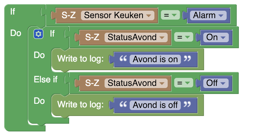

Example which triggers both error logs:
Example nested blog with bug.png (90.49 KiB) Viewed 436 times
