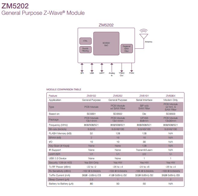

The same board at Amazon:
https://www.amazon.com/Intelligent-Z-wa ... B016D4Z37Q
SM-M1 Smart Home Module
Xenon SM-M1 smart modules selected from the most advanced smart home Z-Wave protocol, ZM5202 hardware module within the existing node control functions previously written software, Z-Wave node function, access to Z-Wave Intelligent Systems. Xenon SM-M1 for small and medium size manufacturers to solve the difficulties of the early technology development, saving a lot of development time and costs, especially in the early manufacturer of electrical test intelligent system access and a small amount of trial production, there is great value.
Single product customization:Xenon SM-M1 on ZM5202 hardware node function control module programming software directly, save hardware costs, guarantee convenience and yield production line of hardware products for intelligent single product lot of customization.
Master Gateway: Xenon systems provide Z-Wave master gateway and technical support, we can build up a test platform and the node with the production of forming system sold together.
loud services:Xenon systems provide access to the cloud, eliminating the difficulties of equipment installation and maintenance, but also can build more value-added services. Feel free to contact the project manager to discuss business cooperation. Select the following desired function model, add a module to the product circuit board can be used. Z2-P1: intelligent socket, power switch Z2-P2: intelligent socket, power switch, power meter Z2-D1: Dimmer Z2-S1: Door/windows Sensor Z2-S2: temperature, humidity, luminance meter Z2-S3: remote control to select the scene Z2-C1: electric curtain motor control Z2-R1: IR control repeater
Features *Pad and pin compatible with the ZM3102 and ZM4102*ITU G.9959 compliantModule*Optimized 8051 CPU Core*128kb flash *16KB SRAM*UART with speed up to 230.4kbps*2 interrupt inputs *4-channel 12/8-bit rail-to-rail ADC with VDD/internal/external voltage reference*PWM Output
The comparable Sigma board ZM5202
https://drive.google.com/open?id=0B-NJR ... TNEUHZDdUE
ZM5202 Capture.JPG (56.58 KiB) Viewed 8465 times

Same chip...
https://forum.mysensors.org/topic/3685/z-wave-sensor/2
They ask some nice questions though...
How about the cost of the sdk?
LouiS22
Posts: 433
Location: Budapest, Hungary
Re: Cheap chinese z-wave products
Post by LouiS22 »
trixwood wrote:Same chip...
AFAIK you have to pay 3000 USD/year and that's just the membership fee. I've checked their website a long time ago, the SDK also cost a lot as well as the approval. So in general, that's what we pay at the retail store :)

On my follow-on question to the supplier of A-low-cost-fully-integrated-Z-wave-module
( http://nl.aliexpress.com/store/product/ ... 42104.html ):
Is Z-wave already loaded in the chip?
I received the answer:
Yes,z-wave has been loaded chip inside.
That sounds promising.
No SIGMA SDK needed?
The proof of the pudding is the eating!
