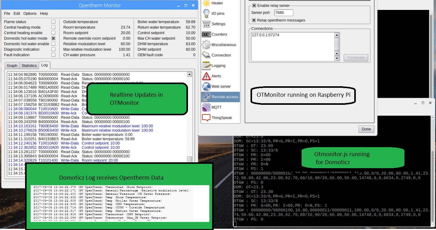

@jake let's see if we can get this done this XMas ;)
I have changed it a little, you can now tell which data field is to be replaced by 'fieldnumberInPsOutputToReplace'. As there are 25 of them in the PS1 output, choose wisely (and yes, I've filled in the default fieldnumber 16 now (+1 :mrgreen: ) (and in the code is the complete list as on the OTGW website ;). Next to that you can also choose the Opentherm ID of what to put in that (e.g. 29 (Decimal, not hex) for the Solar).
#!/usr/bin/node
Make a small listener that Domoticz can connect to as if it was the real otmonitor application.
Then relay the messages between OTGW and Domoticz such that otmonitor is still fully functional.
author: ernorv
v1.0 - Special

ernorv wrote:@jake let's see if we can get this done this XMas ;)
Specifying id = id is a bit more complicated, as I then have to get all the IDs used in the first place, although they are now in copied list of course.
BTW Hope the Dutch is gone now
Thanks for this nice improvement to the code. This makes it for more people intesting to modify to their needs, if needed. Unfortunately there must be a small error somewhere, since this is the response while starting the script:
pi@domoticz-pi ~/node_modules $ node otgwmod.js
Application started.
Server for Domoticz is now listening, point Domoticz OTGW Hardware to port 7689.
events.js:85
      throw er; // Unhandled 'error' event
Error: connect ECONNREFUSED
    at exports._errnoException (util.js:746:11)
    at TCPConnectWrap.afterConnect [as oncomplete] (net.js:983:19)
This time, I wisely chose 11 (DHW temperaturate) as my replacement parameter, to nicely blend in the Solar Boiler acting as a normal hot water boiler, but then with a free energy source, the sun. :)
I added the startup of the otgw.js to Supervisor. Therefore I have a hard time figuring out if something is wrong. Since the RPI is already booted and therefore both otmonitor and otgw scripts are running, I can't see very well if there was an error.
Is it possible to manually stop (and not auto restart) the otgw.js script?
Is it also possilbe that the startup order of both scripts is important?

Re: OTmonitor and Domoticz parallel access to OTGW
Post by ernorv »
@jake yes you are right, there is a dependecy on OTGW to be already running :oops: therefore now with actual checking if the port is opened, without throwing an error, and if no connection could be made to the OTGW, simply reschedule after 10 seconds. This should be much better (also in my own setup that is :D ). Next to that I realised some minor other errors, like choosing number '11' would actually be off with 1, and actual checking if the port for Domoticz is free or not (as mentioned earlier somewhere in this thread).
And because I was enjoying it too much, I also rewrote the Opentherm parsing a bit to be more splitted into it's own function, but that's just for the coders out there I guess.
as for your supervisor parts, you could actually stop the service for a while and start manually to look at the output:
- sudo supervisorctl stop otgwNode <- or whatever you called it
- node otgw.js
and later start it again with sudo supervisorctl start otgwNode
or enable the loggins to be generated in the supervisor configuration files and use: sudo supervisorctl tail -f otgwNode
So here we go again:
author: ernorv
v2.0
	- rewrote the OpenTherm parts to be splitted into separate function
	- added check whether port are actually opened, if no connection to OTGW, wait ten seconds and retry
		this can happen if starting both this script and OTGW, where OTGW needs some time
	- added check if we could open a port for Domoticz, now nicely goes out of the function without throwing an error
	- added specific author section for debugging purposes
	- fieldnumberInPsOutputToReplace was actually off with 1, so now if you set it to 11, it will be 11 according to the list below
var portNumberForDomoticzToUse     = 7689;   // The new port that Domoticz needs to use. In Domoticz, set this number as the port under the OTGW hardware
var portNumberOfOtMonitor          = 7686;   // The network port OTGW provides, as can be set under the Configuration parts
const replaceTTwithTC              = true;   // If true: use TC instead of TT (if false, just standard Domoticz TT usage)
// -------------- Normally no further settings required below this line
var resetOTGW_PS_state             = true; // default true: sets the PS state back to 0 after Domoticz has its data, is what allows otmonitor to keep making nice graphs as if Domoticz was not there
// -------------- just if you really know what you do, set these
var replaceAnIdInDomoticzOutput    = true; // default: false! set this to true for replacement of the DHW Setpoing with Solar Temperature
var idToUseForReplacement          = 29;   // (Decimal) ID of the Opentherm message to use. 29 refers to the Solar Boiler Temperature
var fieldnumberInPsOutputToReplace = 11;   // which field to replace in PS output to replace, see numbers below
	The PS1 output has 25 field: see http://otgw.tclcode.com/firmware.html#dataids
	The OTGW outputs the following fields (normally that is). I have given them below. Set the 'fieldnumberInPsOutputToReplace' to the
	fieldnumber in accordance with what you like to be replace, given these fields (default is 16):
	1)  Status (MsgID=0) - Printed as two 8-bit bitfields
	2)  Control setpoint (MsgID=1) - Printed as a floating point value
	3)  Remote parameter flags (MsgID= 6) - Printed as two 8-bit bitfields
	4)  Maximum relative modulation level (MsgID=14) - Printed as a floating point value
	5)  Boiler capacity and modulation limits (MsgID=15) - Printed as two bytes
	6)  Room Setpoint (MsgID=16) - Printed as a floating point value
	7)  Relative modulation level (MsgID=17) - Printed as a floating point value
	8)  CH water pressure (MsgID=18) - Printed as a floating point value
	9)  Room temperature (MsgID=24) - Printed as a floating point value
	10) Boiler water temperature (MsgID=25) - Printed as a floating point value
	11) DHW temperature (MsgID=26) - Printed as a floating point value
	12) Outside temperature (MsgID=27) - Printed as a floating point value
	13) Return water temperature (MsgID=28) - Printed as a floating point value
	14) DHW setpoint boundaries (MsgID=48) - Printed as two bytes
	15) Max CH setpoint boundaries (MsgID=49) - Printed as two bytes
	16) DHW setpoint (MsgID=56) - Printed as a floating point value
	17) Max CH water setpoint (MsgID=57) - Printed as a floating point value
	18) Burner starts (MsgID=116) - Printed as a decimal value
	19) CH pump starts (MsgID=117) - Printed as a decimal value
	20) DHW pump/valve starts (MsgID=118) - Printed as a decimal value
	21) DHW burner starts (MsgID=119) - Printed as a decimal value
	22)	Burner operation hours (MsgID=120) - Printed as a decimal value
	23)	CH pump operation hours (MsgID=121) - Printed as a decimal value
	24) DHW pump/valve operation hours (MsgID=122) - Printed as a decimal value
	25) DHW burner operation hours (MsgID=123) - Printed as a decimal value
// ------------- do not use, specific for author ---------------
var   extraDebug      = false;
const authorOverrides = false; // for anybody out there, keep this to false !!!
if (authorOverrides) {
	portNumberForDomoticzToUse     = 17689;   // for test, do not interrupt normal running process, so throw it somewhere else
	resetOTGW_PS_state             = false;   // not to interfere with the actual program already runing
	idToUseForReplacement          = 25;      // (Decimal) ID of the Opentherm message to use. I use 25 for test purposes
	fieldnumberInPsOutputToReplace = 11;      // which field to replace in PS output to replace, see list above
	extraDebug = true;

jake
Posts: 751
Re: RE: Re: OTmonitor and Domoticz parallel access to OTGW
Post by jake »
ernorv wrote:@jake yes you are right, there is a dependecy on OTGW to be already running :oops: therefore now with actual checking if the port is opened, without throwing an error, and if no connection could be made to the OTGW, simply reschedule after 10 seconds. This should be much better (also in my own setup that is :D ). Next to that I realised some minor other errors, like choosing number '11' would actually be off with 1, and actual checking if the port for Domoticz is free or not (as mentioned earlier somewhere in this thread).
- node otgw.js
Thanks for explaining the supervisor commands. I looked on the web for a manual on https://pypi.python.org/pypi/ordered-st ... pervisord/ in supervisor. The addition of priority = 100, 200 etc, combined with autostart false did not result in running scripts of otmonitor and otgwmod, therefore your autocheck is helpful. With the 'new' supervisor commands I stopped, replaced the code and manually restarted the script again, with the following output as a result:
pi@domoticz-pi ~ $ sudo supervisorctl stop otgw_mod
otgw_mod: stopped
pi@domoticz-pi ~ $ node ./node_modules/otgwmod.js
Connected to OTGW server at port number 7686!
/home/pi/node_modules/otgwmod.js:280
            valstr = ("0").repeat(8-tmpstr.length) + tmpstr + "/" ;
TypeError: undefined is not a function
    at parseMessage (/home/pi/node_modules/otgwmod.js:280:28)
    at Socket.<anonymous> (/home/pi/node_modules/otgwmod.js:153:25)
    at Socket.emit (events.js:107:17)
    at readableAddChunk (_stream_readable.js:163:16)
    at Socket.Readable.push (_stream_readable.js:126:10)
    at TCP.onread (net.js:529:20)
I also looked in the messages in OTmonitor again and was puzzled by the every changing string from the solar storage temperature. Finally I think I understand that part, it is the read-data 'string' that is all the time the same "T001D0000". While trying to understand your code, I don't see how the MsgID=29 gets translated in a search for T001D0000, but I assume I miss a link between them, T001D0000 probably being a chain of bits that all mean something.
ernorv
Posts: 17
Joined: Sunday 13 November 2016 10:42
Post by ernorv »
@jake looks like your node version again, maybe update the node version? (google that, is what I do usually) for now, comment those lines out: place a '//' in front of it, they are there twice (two lines below the first one, somewhere around line number 288)
have a look at: http://thisdavej.com/upgrading-to-more- ... pberry-pi/ for how to change your (MAJOR) version of NodeJS
With respect to the searching: yes those Txxxxxxx do mean a lot, that is actually where the magic happens. As I found on the OTGW website, the T means that the Thermostat is sending something, and the B is the Boiler answering. Now there are requests for reads and writes going on there, that is where the first character after the T/B comes into play. This one is nasty, as there is some other info in there, a so-called parity bit, makes it difficult for humans to read. This is why I now first get rid of the parity bit. Now I can see what kind of message it is, an instruction to read or write, an acknowledge to that (normally actually containing the real information we are looking for). The (opentherm) ID itself is coded in hexadecimal by characters number 4 and 5, this is what I now store under otMsgId.
Having this ID, I have pre-coded for some messages how to decode the values, as Float / Integer etc. The list is expandable for future use of course. Id 29 is defined as a Float value ;) So now I can decode the message and provide it back to the main part of the code. The latter checks that it is an acknowledge type (either read or write) and checks whether it is the right ID. If so stores it for when domoticz asks for a new update with the PS1 thingy.
jake
Posts: 751
Post by jake »
ernorv wrote:@jake looks like your node version again, maybe update the node version? (google that, is what I do usually) for now, comment those lines out: place a '//' in front of it, they are there twice (two lines below the first one, somewhere around line number 288)
With the following lines commented out:
 case "asFlags":
    var tmpstr = (otObject.asUInt >>> 8).toString(2);
    tmpstr = ((otObject.asUInt >>> 0)&0xFF).toString(2);
    // valstr += ("0").repeat(8-tmpstr.length) + tmpstr;
    value  = otObject["asUInt"];
    break;
 case "asROF": // remote override function: the TT/TC, special treatment here
    otObject.asStatus = ((otObject.asUInt & 0x0300) ? (((otObject["asUInt"] & 0x0100) ? "TC" : "T$
    value = valstr;
    break;
I still have the following error thrown at me, which is te line I commented out, very strange:
About nodejs, I have this strange V0.12.1 version running, something I can't match at all with a current version of 7.3.0. 2 suspected reasons for this: I'm running on a RPI 1b (arm6, not arm7) and Wheezy, not Jessie. I checked the website, but commands like 'apt' are probably not meant for my old system, since that only accepts the apt-get. A sudo apt-get install nodejs tells me that I am 'up to date', although I expect that there are more up to date versions out there.
I guess, I should follow the instructions on this page, right?
ernorv
Posts: 17
Post by ernorv »
@jake for both parts where you commented out, look also two lines above and do the same ;)
for your case you do not need these representations, they are just there fore genericity.... will think a bit how to check if the function exists....... hmmm
- edit -
v0.12.x is not strange, don't worry, just bit old. On my pi3 I use version 7.x already.
- edit - Found it, was easy actually. Now also still compatible with 0.12.x :D

// ---------------------- start the server for active listening ----------------
server.listen(portNumberForDomoticzToUse, function() {
   console.log('Server for Domoticz is now listening, point Domoticz OTGW Hardware to port '+ portNumberForDomoticzToUse + '.');
console.log('Application started.');
Last edited by ernorv on Wednesday 28 December 2016 19:36, edited 1 time in total.

I had to wait for 15 minutes to see the solar boiler value updating in Domoticz, since I already knew that this value only comes around every 15-20 minutes in the OT-log, but now it is working as expected.
Well done and thanks a lot!

#!/usr/bin/node
author: ernorv
v2.0
	- for older node versions, plug in the repeat function for string.
V2.1
	- add possibility to replace multiple values
/* 	Definition of what to replace and where. This is now a list, to allow multiple replacements
	idToUseForReplacement          (example:  29)   (Decimal) ID of the Opentherm message to use. 29 refers to the Solar Boiler Temperature
	fieldnumberInPsOutputToReplace (example: 11)    which field to replace in PS output to replace, see numbers below
	example single field:
	replaceDefinition = [ {fieldnumberInPsOutputToReplace : 11, idToUseForReplacement : 25} ];
	example two fields:
		{fieldnumberInPsOutputToReplace : 11, idToUseForReplacement : 25},
		{fieldnumberInPsOutputToReplace : 12, idToUseForReplacement : 24}
	(mind the ',' required when adding a definition to the list)
var replaceDefinition = [
	{fieldnumberInPsOutputToReplace:11, idToUseForReplacement:29}
	extraDebug = true;
} // authorOverrides
var net = require('net');
var server
var otgwSocket
var domSocketsArray = [];
// -------------- some init stuff to do ------------------------------------------
for (var k=0; k<replaceDefinition.length; k++) {
	replaceDefinition[k].currentReplacementValue = 0; // init with a value to start with until seen for the first time
// -------------- DEFINE SERVER LISTENING FOR CONNECTIONS FROM DOM ---------------
server = net.createServer(function (socket) {
	console.log('Incoming Domoticz Connection...');
	domSocketsArray.push(socket);
	socket.on('data', function (data) {
		data = data.toString(); // data may come in as Buffer
		console.log('DOM: ' + data.replace(/[\r\n]*$/, "").replace(/\r\n/g, ','));
		if (! otgwSocket.destroyed) {
			if (replaceTTwithTC) {
				otgwSocket.write(data.replace("TT=", "TC="));
			} else {
				otgwSocket.write(data);
	socket.on('end', function() {
		console.log('end');
		domSocketsArray.splice(domSocketsArray.indexOf(socket), 1);
	socket.on('error', function () {
		console.log('DOM: detected error on socket: probably otgwSocket died');
	socket.on('close', function () {
		console.log('DOM: socket closed');
server.on('error', function(err) {
	console.log('Could not open the port ' + portNumberForDomoticzToUse + ' for Domoticz to connect to.');
	console.log('Please check whether the port is actually free to use, and adapt the "portNumberForDomoticzToUse" in the script.');
	console.log('A common source for this is that one uses the port number of the OTGW instead of a free one.')
	process.exit(1);
// ---------------- CONNECT TO OTGW ----------------
function relayToClients(data) {
	for (var i =0 ; i < domSocketsArray.length; i++) {
		if (! domSocketsArray[i].destroyed) {
			domSocketsArray[i].write(data);
var resetPS1 = false;
var currentReplacementValue = 0; // init this with 0
function connectToOTGW() {
	otgwSocket = net.createConnection({port: portNumberOfOtMonitor}, function() {
	  console.log('Connected to OTGW server at port number ' + portNumberOfOtMonitor + '!');
	otgwSocket.on('data', function(data) {
		data = data.toString(); // data comes in as Buffer, we want to use it as string
		if (data.match(/[BTARE][0-9ABCDEF,]{8}/)) {
			// this data is not for Domoticz, it is what makes the normal otmonitor app work
			// console.log('<not relayed> OTGW: ' + data.toString().replace("\r", '').replace('\n', ''));
			// this data can contain a possible value for replacement purposes, inspect it.
			if (replaceAnIdInDomoticzOutput || extraDebug) {
				var otObj = parseMessage(data);
				if (replaceAnIdInDomoticzOutput && (otObj.readAck || otObj.writeAck)) {
					for (var k=0; k < replaceDefinition.length; k++) {
						if (otObj.otMsgId == replaceDefinition[k].idToUseForReplacement) {
							replaceDefinition[k].currentReplacementValue = (otObj.recognized) ? otObj.valstr : otObj.asFloat.toFixed(2);
							console.log("New replacement value found: (msgid " + otObj.otMsgId + ": '" + otObj.name + "') : " + replaceDefinition[k].currentReplacementValue);
		} else {
			console.log('OTGW : ' + data.replace(/[\r\n]*$/, "").replace(/\r\n/g, ','));
			// sometimes there is a PR:,I=00 on the line which ends up in Domoticz status log. It looks like
			// malfomed data coming from the OTGW itself. Let's do some cleaning up, keeping the status log clean
			data = data.replace(/PR:[ ]*,/g, "PR: ");
			data = data.replace(/PR, /g, "PR: ");
			// a difficult one: this happens every so often, a comma missing in the output of the OTGW PS=0 output, let's repair this
			data = data.replace(/([01]{8}\/[01]{8},[0-9\.]{4,6},[01]{8}\/[01]{8})([0-9\.]{4,6}.*)/, "$1,$2");
			/* Now we can replace a field in the output to Domoticz with another one, as long as the one to read has also a
			 * floating point definition (bit technical, but if you like, google for the specification of the Opentherm itself).
			 * This implies that we can only put it into a Domoticz field that also understand this floating point definition.
			 * Most temperatures are by the way. Also the (Opentherm ID) needs to be filled in. These are both done above in the
			 * const definition section of the script.
			if (replaceAnIdInDomoticzOutput) {
				tmp = data.split(',')
				if (tmp.length == 25) { // for the PS1 output we expect 25 fields: see http://otgw.tclcode.com/firmware.html#dataids
						tmp[replaceDefinition[k].fieldnumberInPsOutputToReplace-1] = replaceDefinition[k].currentReplacementValue;
					data = tmp.join(",");
					console.log("RPLC : " + data.replace(/[\r\n]*$/, ""));
			relayToClients(data);
		if (data.indexOf('PS: 1') !== -1 ) {
			// Domoticz is issueing a PS1 command, reset it if indicated by the settings above
			resetPS1 = resetOTGW_PS_state;
		if (resetPS1 && (data.match(/[01]{7,9}\/[01]{7,9},.*/))) {
			// ok the data requested by domoticz has been produced, now go back to normal otmonitor operation
			otgwSocket.write('PS=0\r\n'); // no need to test for destroyed here, data just arrived from it
			resetPS1 = false;
	otgwSocket.on('end', function() {
		console.log('OTGW disconnected from server, reconnecting in 1 second.');
		setTimeout(function() { connectToOTGW(); }, 1000)
	otgwSocket.on('error', function(err) {
		console.log('==> Could not connect to the OTGW at port ' + portNumberOfOtMonitor);
		console.log('==> Make sure the OTGW is running and set to provide the port as given above.');
		console.log('==> Will try to reconnect in 10 seconds, maybe OTGW is just starting up here.');
		setTimeout(function() { connectToOTGW(); }, 10000);
	otgwSocket.on('close', function() {
		console.log('otgwSocket Close part');
//-------------------------- function for extra debug --------------------
// apparently the String.repeat does not always exists, depending on Node version, define one if needed
if (typeof(String.prototype.repeat) == 'undefined') {
    console.log('String.repeat does not exist, adding a prototype definition (normal for older NodeJS versions).');
	String.prototype.repeat = function(n) {
		var tmpstr = "";
		for (var i=0; i < n; i++) tmpstr += this ;
		return tmpstr
// the following is a list of already known IDs and how to convert them
// otdef[OTMSGIDasDecimal] = {'readable name', '[asFlags|asFloat|asUInt|asSInt|asFlags]'
var otdef  = {};
otdef[0]   = {name:"Master and slave status flags", val:"asFlags"}; // read ack: slave, read-data: master
otdef[5]   = {name:"Application Specific Flags", val: "asFlags"};
otdef[9]   = {name:"Remote Override Room Setpoint", val: "asFloat"};
otdef[11]  = {name: "TSP Setting", val: "asTSP"}
otdef[14]  = {name:"Maximum Relative Modulation Level", val: "asFloat"};
otdef[16]  = {name:"Room Setpoint", val: "asFloat"};
otdef[17]  = {name:"Relative Modulation Level", val: "asFloat"};
otdef[18]  = {name:"Water Pressure", val: "asFloat"};
otdef[24]  = {name:"Room Temperature", val: "asFloat"};
otdef[25]  = {name:"Boiler Water Temperature", val: "asFloat"};
otdef[26]  = {name:"DHW Temperature", val: "asFloat"};
otdef[27]  = {name:"Outside Temperature", val: "asFloat"};
otdef[28]  = {name:"Return Water Temperature", val: "asFloat"};
otdef[29]  = {name:"Solar Boiler Temperature", val: "asFloat"};
otdef[56]  = {name:"DHW Setpoint", val: "asFloat"};
otdef[57]  = {name:"Max CH water Setpoint", val: "asFloat"};
otdef[100] = {name:"Remote Override Function", val: "asROF"};
otdef[120] = {name:"Burner Operation Hours", val: "asUInt"};
otdef[121] = {name:"CH Pump Operation Hours", val: "asUInt"};
otdef[122] = {name:"DHW Pump/Valve Operation Hours", val: "asUInt"};
function parseMessage(data) {
	 * this function parses those B12345678 like messages and returns the information
	 * in case it is either a read-ack or a write-ack, such to simplify the msgs as
	 * from the OTGW side. The instruction before are not so interesting, as we would
	 * like to see the actual information in the datastreams.
	// byte 2 is data-id, byte 3 and 4 contain the data value
	// byte 1: parity bit, 3 bits msg type and 4 bits spare, hence mind the parity
	data = data.substr(0,9);  // remove extra newline stuff
	data = data[0] + (parseInt(data[1], 16)&0x7) + data.substr(2); // remove that parity bit for more consistent reading
	var otObject = {recognized: false,
					readData  : parseInt(data.substr(1,1), 16) == 0,
					writeData : parseInt(data.substr(1,1), 16) == 1,
					readAck   : parseInt(data.substr(1,1), 16) == 4,
					writeAck  : parseInt(data.substr(1,1), 16) == 5,
					otMsgId   : parseInt(data.substr(3,2), 16),
					asFloat   : ((parseInt(data.substr(5,2))&0x80)>0?-1:1) *
								((parseInt(data.substr(5,2), 16)&0x7F) + (parseInt(data.substr(7,2), 16))/256.0 ),
					asUInt    : parseInt(data.substr(5,4), 16),
					asSInt    : ((parseInt(data.substr(5,4), 16) + 0x8000) & 0xFFFF)-0x8000,
					asStatus  : "",
					data      : data};
	var valstr
	var value
	if (otdef[otObject.otMsgId]) {
		otObject.recognized = true;
		switch (otdef[otObject.otMsgId].val) {
			case "asFloat" :
				valstr = otObject[otdef[otObject.otMsgId].val].toFixed(2);
				value  = otObject[otdef[otObject.otMsgId].val];
				break;
			case "asFlags":
				break;
				otObject.asStatus = ((otObject.asUInt & 0x0300) ? (((otObject["asUInt"] & 0x0100) ? "TC" : "TT")) : "") ;
				value = valstr;
				break;
			case "asTSP": // special: just print it
				var hb = (otObject.asUInt >>> 8);
				var lb = ((otObject.asUInt >>> 0)&0xFF);
				valstr = "Parameter " + (hb + 1) + ": " + lb ;
				value = otObject.asUInt;
				//console.log("====>  Parameter " + (hb + 1) + ": " + lb );
				break;
			default :
				valstr = otObject[otdef[otObject.otMsgId].val] + "";
		otObject.name = otdef[otObject.otMsgId].name;
		otObject.valstr = valstr;
		otObject.value  = value;
	} else {
		// unknown id used here, do not know how to convert
	if ((otObject.otMsgId != 0) & (otObject.otMsgId != 1) &
	    (otObject.readAck | otObject.writeAck) & extraDebug) { // 0 is the standard status report, bit boring
		if (otObject.recognized) {
			console.log(otObject.data.replace(/[\n\l\r]/g, "") +" ("+otObject.otMsgId+")" + " " + otObject.name + " : " + otObject.valstr);
		} else {
			console.log(otObject.data.replace(/[\n\l\r]/g, "") + " : " + JSON.stringify(otObject));
	return otObject
} // parseMessage
// instruct this program to connect to the otmonitor application
connectToOTGW();

Finally had some time to set this up:
Works excellent with the instructions provided in this thread. I use the node file with version v2.0.0.
Unfortunately It did not yet help me resolve the issue where otmonitor says:
Opentherm Gateway 4.2.5
WDT reset!
Only a powercycle brings the OTGW back to live, as I did not implement the reset button. I could use Mysensors to toggle the reset button ofcourse... now I just powercycle using a KaKu plug... Well in the end a reset should not be necessary. Just trying to figure out why this happens.

I'm note sure wether or not this is usefull for other Domoticz/OTGW users.
My situation:
I run OTGW and i like to use some features of OTmonitor but at the same time i want to have control of the thermostat using Domoticz. I run otmonitor as daemon on Linux and patched the OTGWBase.cpp to re-enable PS=0 after the Domoticz plugin received the PS=1 information so that OTMonitor remains functional. This generates some extra logging but besides that it works quite nicely. This is probably not the best way to handle this but this has helped me for more than a year now and I'm able to use both otmonitor and Domoticz parallel. I hope it helps others with the same problems ;)
usleep is required so that the serial data is received before sending data, lowering this value might cause missing data.
diff --git a/hardware/OTGWBase.cpp b/hardware/OTGWBase.cpp
index 7fd1dc7..e119efe 100644
--- a/hardware/OTGWBase.cpp
+++ b/hardware/OTGWBase.cpp
@@ -249,6 +249,9 @@ void OTGWBase::GetGatewayDetails()
 	WriteInt((const unsigned char*)&szCmd, (const unsigned char)strlen(szCmd));
 	strcpy(szCmd, "PS=1\r\n");
+	usleep(500000);
+	strcpy(szCmd, "PS=0\r\n");
+	WriteInt((const unsigned char*)&szCmd, (const unsigned char)strlen(szCmd));
