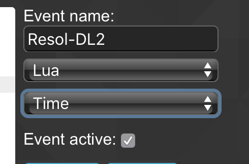

One more question: I have made the script in Domoticz 'Events' it is now constantly running (every few seconds), is there a way to set this to every x minutes?

[ Set the script to run on time, and with run every minute.

Check! Thanks again....

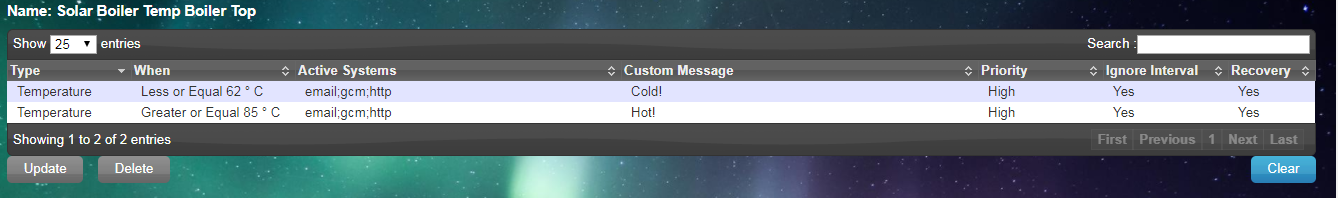

I'm trying to get notifications working, depending on temperature of the top of the boiler, see attachment. Somehow, they are not being kicked off....Can't see what I'm doing wrong.

No one has the same issue?
