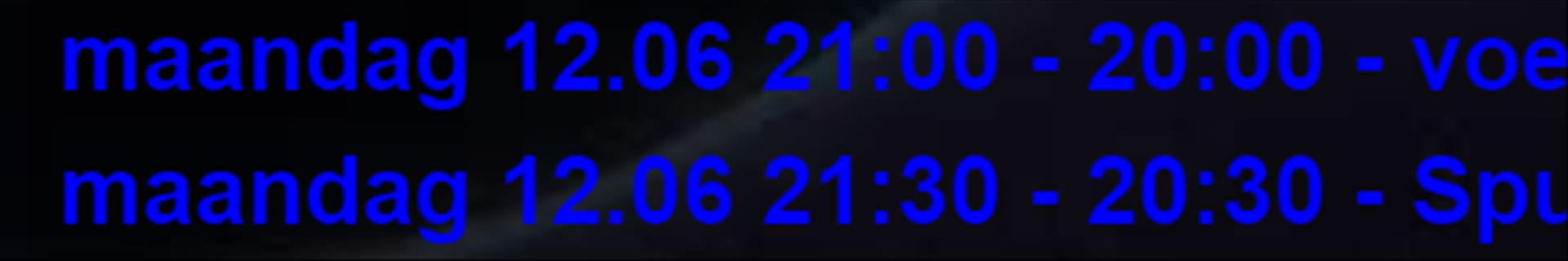

my calendar give the wrong format...
First the end time...
And then the start
Hope some one get......
Re: Dashticz - Module - Calendar
Posted: Monday 12 June 2017 14:56
by gielie
When i have a recurrent appointment on a weekly base, i get 2 strings with the same info.
The first one is recurrent every week form 20.00 - 22.30
the second is only one item, here the date and time is correct
the third is also recurrent every week from 19.30 - 21:30
What is going wrong?
btw this is an apple iCloud calendar
