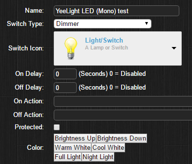

I'm fixing up some of the Yeelight commands, and for the mono light there is warm and cool white buttons. Are these modes possible with the mono light?
deennoo
Posts: 784
Location: Bordeaux France
Re: RE: Re: [Plugin now available in Beta] Help with Yeelight Bulb
Post by deennoo »
corbin wrote:I'm fixing up some of the Yeelight commands, and for the mono light there is warm and cool white buttons. Are these modes possible with the mono light?
No works with rgbw too, all my test are made with this one
