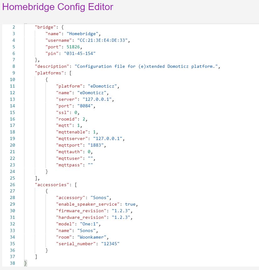

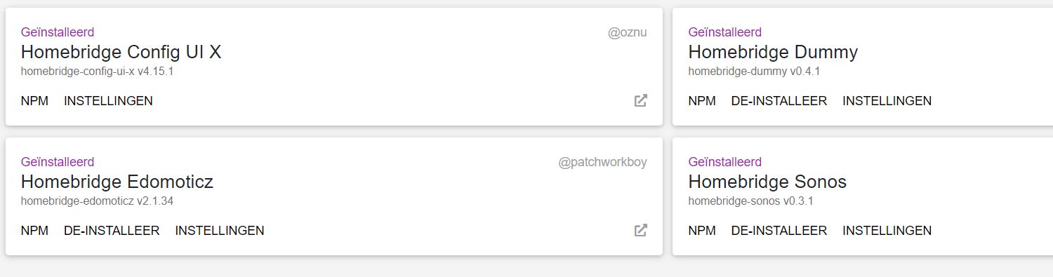

these are my settings.
some time ago i had problems with homebridge. things were outdated but upon updating it rebooted and rebooted.
after a while everything got updated and was stable again

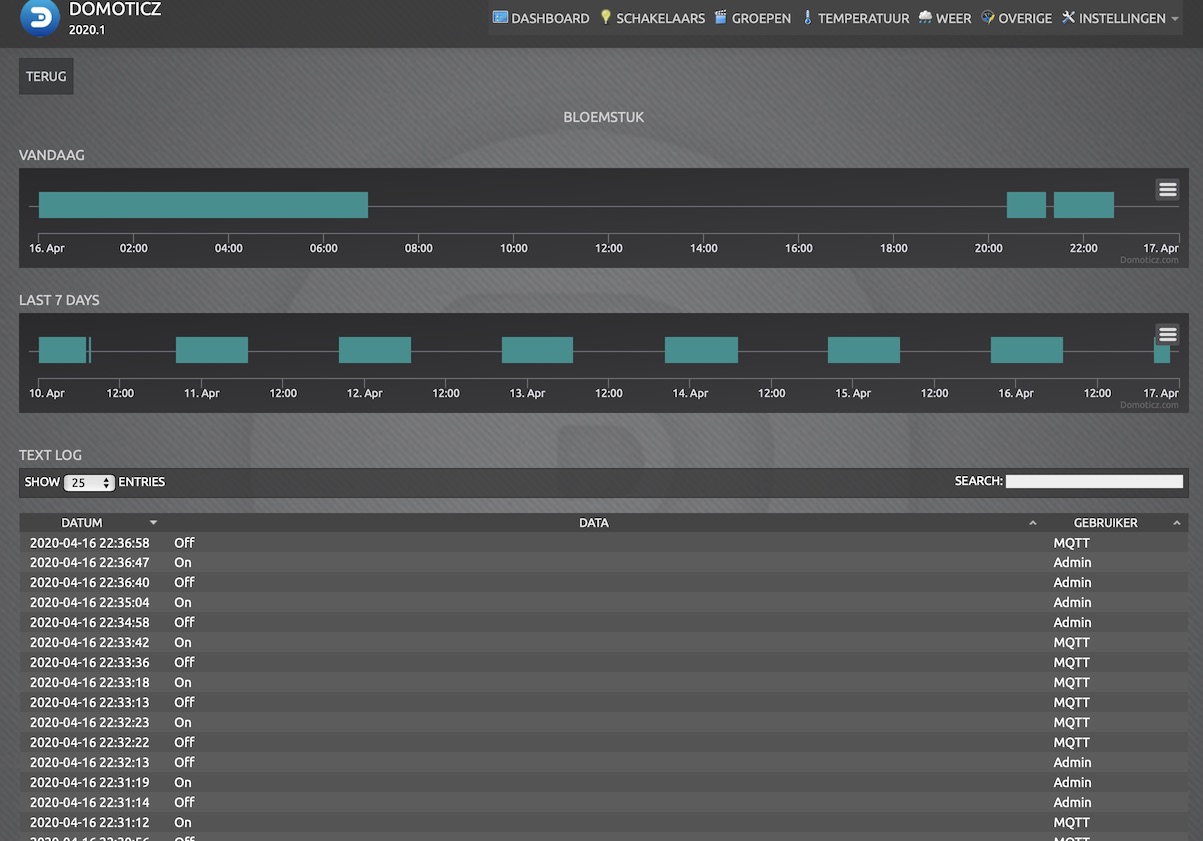

Dug a little deeper and found the following (do not know if related or if I am messing everything up :))
When I use Home-app the command reaches Domoticz, but doesn't actually change the setting of the switch.
I tested with the switches from Home-app, Pilot-app and Domoticz web and found out that it might depend on the 'User' that is sending the message:
Schermafbeelding 2020-04-16 om 22.40.05.jpg (169.66 KiB) Viewed 2646 times
The messages that have 'Gebruiker' (User) Admin actually change the status of the light and the messages of the 'Gebruiker' MQTT do not do anything.
Device/platform -> Gebruiker
Home app Apple -> MQTT
Homebridge web -> MQTT
Pilot app -> Admin
Domoticz web -> Admin

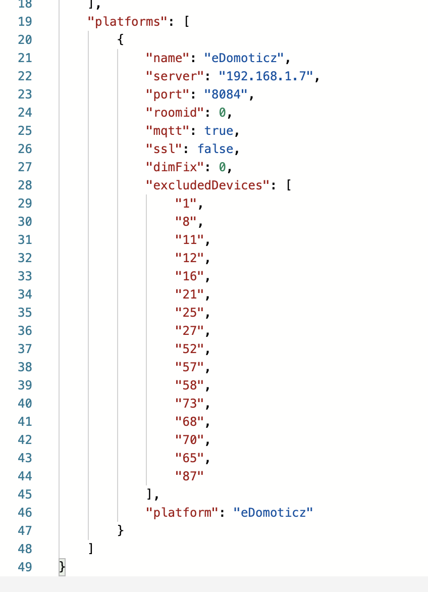

These are my settings of eDomoticz:
Schermafbeelding 2020-04-16 om 22.49.21.png (132.97 KiB) Viewed 2646 times
Is there some way to get MQTT to use Admin as a User?

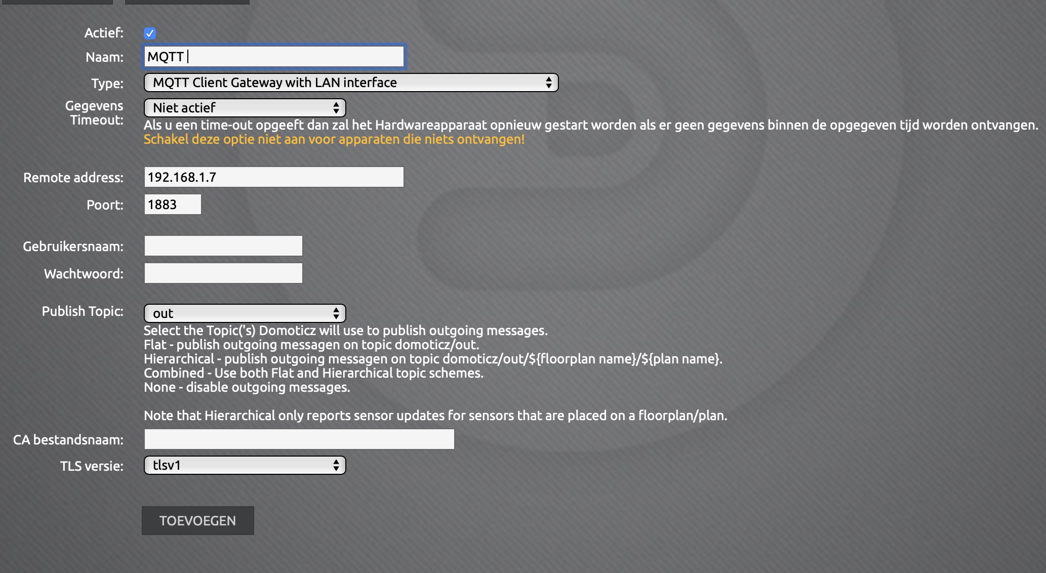

These are my settings of MQTT in Domoticz:
Schermafbeelding 2020-04-16 om 22.51.46 1.jpg (279.14 KiB) Viewed 2646 times

strange.
so the light received the MQTT command as shown in the log but does not switch the light on/off
if you check my settings you can see you can specifiy user and password for edomoticz.
now i really do not know what this does when you fill in admin as the user and leave the password blank but maybe you can try.
if a blank pasword does not work then you might set a password in domomitcz for user admin and user that same password in edomoticz
the domoticz settings seem to default to admin so leave those clear.

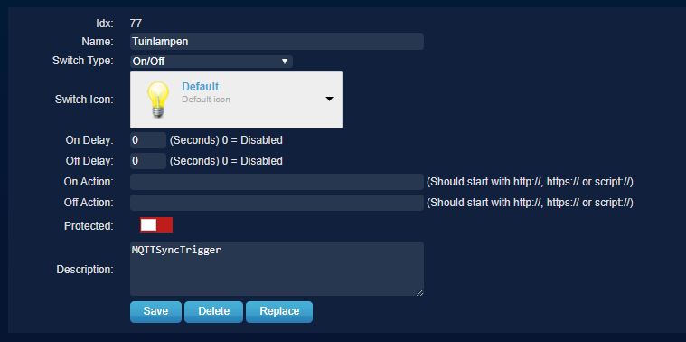

some time ago i wanted to have a MQTT broadcast script which waaren made
this script sends, when triggered, the status of all lights, switches and dimmers through MQTT.
maybe you can use it to solve the the problem you have with the tasmota switches until it is fixed in domoticz(or until Jumbotroll compiles a new version)
it needs you to install mosquitto_pub on your synology because this tool sends out the MQTT command
here it is

            if (dv.deviceType or ''):find('witch') and ( not(MQTTSyncTrigger) or dv.description:find(MQTTSyncTrigger)) then
                dz.log(dv.id .. ', ' .. dv.name .. ', ' .. dv.deviceSubType,dz.LOG_DEBUG)
                osCommand(composeMQTT(dv))
            end)

local MQTTSyncTrigger = "MQTTSyncTrigger"
did you also put MQTTSyncTrigger in the description field of device Verlichting Achtertuin?
if not change this(the top ones where it says your settings)
also check the domoticz log that is is sending out the mqtt command.
if the script gets called without errors and you change the MQTTSyncTrigger then it must broadcast the status of all your switches
