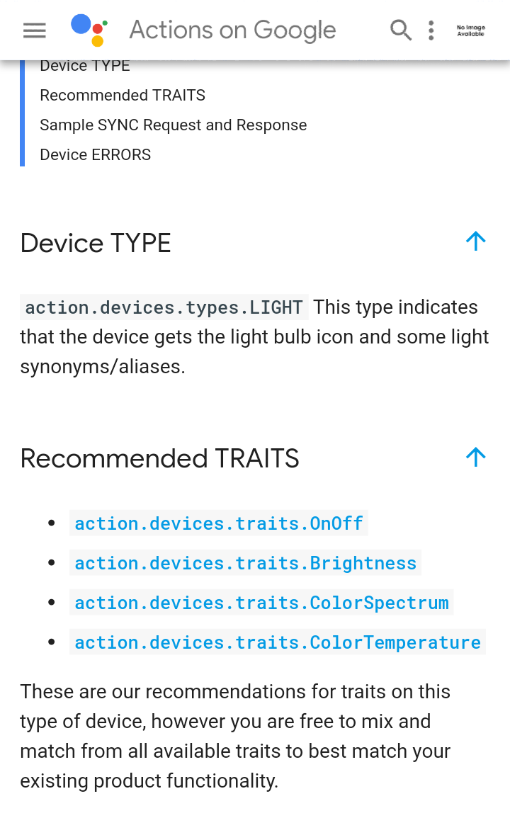

Found the Google documentation about RGB lights.
https://developers.google.com/actions/s ... ides/light
Apperantly the device type 'Light' has the traits 'brightness', 'colorspectrum' and 'colortemperature'. However no saturation. So RGB is supported RGBW not (fully). Maybe it is possible to use RGB value FFFFFF as white or something like that? I believe the Google Assistant also sends the detected color as string back in the request.

Madgeni wrote: Sunday 14 October 2018 19:27 You can set warm/cold white - is that what you mean?
No with saturation I mean the mix between white and RGB(colorspectrum).
With colortemperature you can set the themperature of the color. For white that would be the range between cw/ww. Haven't seen it been used for other colors yet in consumer lighting.
