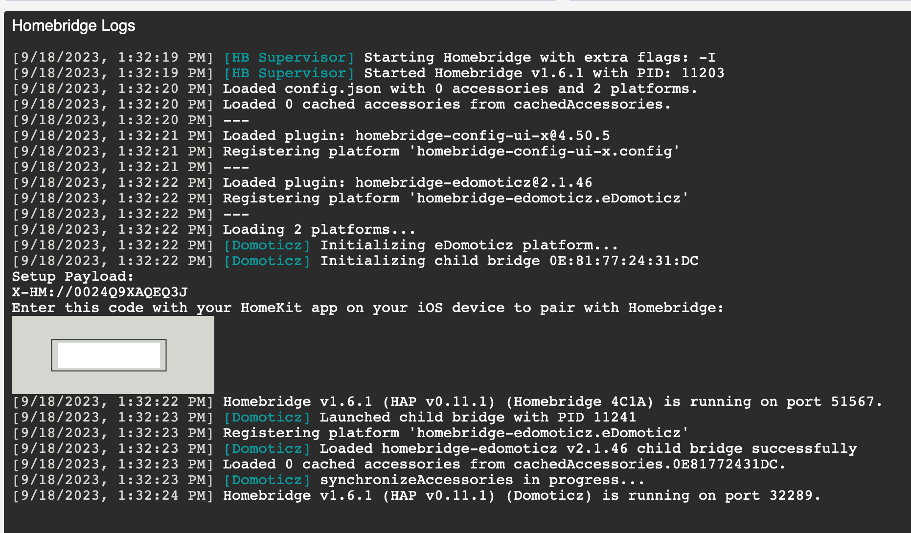

I've got Domoticz 2023.2 running, with the eDomoticz homebrigde plugin, but no luck getting it working.
This is what I tried:
In Domoticz I added 127.0.0.1 and 192.168.0.*. It is connected to a remote shared port (Settings -> Security)
Homebridge started all okay, see below. When I try to add it to Apple Home (add accessory) it says allready added.
So the only problem is that my Domoticz scenes, swithched and lights don't show up in Homebridge i think? How do i get this fixed of get more info in logs?

TroisSix wrote: Monday 18 September 2023 14:59 Change the id and try again
What do you mean? I've done both the reset options in the Homebridge settings (Unpair everything and Reset Accessories) both not succesfull.
Not a single Accessory is loading, also not in the Homebrigde UI, whilst the connection with Domoticz looks good.
EDIT: after I restarted, I changed the config of eDomoticz back and forth again and restarted again, and now it works and shows my Accessories at least in the Homebrigde UI. Still not showing in my Home app...

Perhaps I wasn't clear enough, I meant by changing one letter in the name and username in the config of homebridge + restart of homebridge.
See:
"bridge": {
   "name": "Homebridge eeff",
   "username": "aa:bb:cc:dd:ee:ff",
   "port": 5190,
   "pin": "123-45-678"
Not using Dz anymore.
altaphista
Posts: 12
Joined: Tuesday 05 April 2022 16:40
Domoticz version: 2023.2
Re: homebridge-edomoticz Plugin
Post by altaphista »
TroisSix wrote: Monday 18 September 2023 17:44 Perhaps I wasn't clear enough, I meant by changing one letter in the name and username in the config of homebridge + restart of homebridge.
See:
"bridge": {
   "port": 5190,
   "pin": "123-45-678"
Thanks for your reply TroisSix, but I've tried this a couple of times but no luck. The accessories do show in the homebridge tab, but they won't show after I've added the bridge via 'Add Accessory' in my iOS Home app...

altaphista
Posts: 12
Anybody else any idea why my accessories show up in Homebridge-eDomoticz, but they are unvisible on my Home (or other, i've tried Eve) app on my iPhone, iPad and Macbook? Pairing the Bridge looks succesfull, but none of the accessories appear...
Edit:
Sollution
After strolling down the internetz looking for an answer, somebody suggested to tap Add Accessory again in the iOS Home app, click on "Other options..." and re-init the Bridge. This worked surprisingly!! Hopefully it helps somebody sometime
