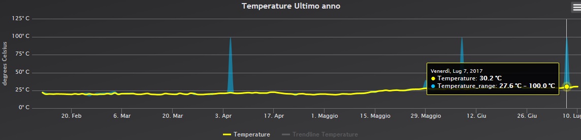

Hi to all,
sometimes all my xiaomi temperature sensors report a strange peak of 100°C and after some minutes turn back to normal.
There's a way for delete this peaks?

Andree wrote:Hi to all,
Press CTRL and click on the peak. Now you can delete it.
Nothing happens with CTRL and click..Same with Firefox,Chrome and Edge..

Andree wrote:
yeah it is SHIFT + click.

bbqkees wrote:
Andree wrote:
Yesss now work!thx so much!
