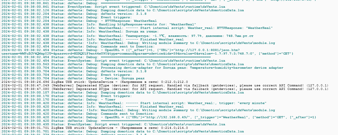

Hi everybody.
Updated from 2022.2 version and see the same messages.
The attachment 2024-02-01_09-42-04.png is no longer available
Yes i read that that is not an error but annoying :oops:
How can i find who is sending and what? And will it cause problems in the future?
Debug mode didnt help.
SystemName "windows"
UseUpdate true
build_time "2024-01-30 11:16:34"
dzvents_version "3.1.8"
hash "731719420"
python_version "3.8.2
status "OK"
title "GetVersion"
version "2024.4"
Only Domoticz and ZigbeeForDomoticz plugin
Posts: 6681
Domoticz version: 2025.1
Re: 15326 - [WebServer] Depricated RType
It is sometjing on your server. Could be scripts, a theme, Dashticz that needs to be updated etc.

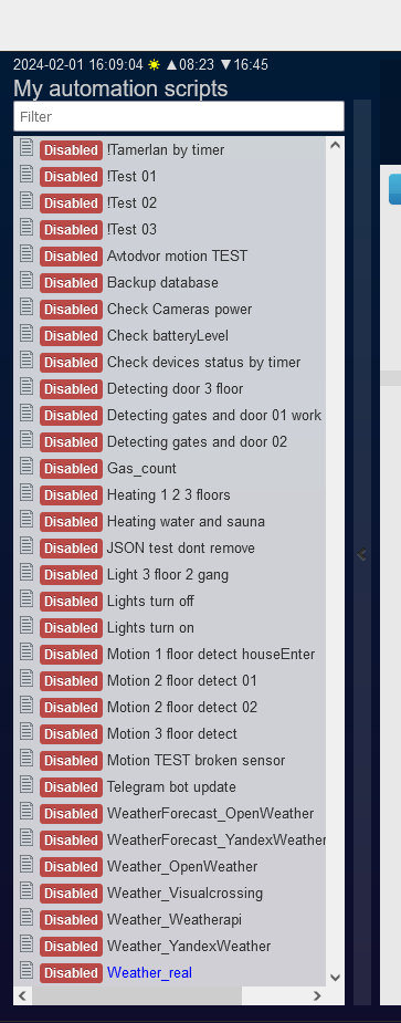

waltervl wrote: Thursday 01 February 2024 13:59 It is sometjing on your server. Could be scripts, a theme, Dashticz that needs to be updated etc.
Only native Theme, no Dashticz.
Scripts... disabled everything.. and the same
It seems that some zigbee device is sending data
How can i filter out the one?
Or may be the old plugin version? Im using 6.3.015
Posts: 6681
Yes could be the zigbee4Domoticz plugin sending these commands. Did you update it recently?
Edit: from Z4D stable 7 the plugin is compatible with the new API.

I also get this [WebServer] Depricated RType message in 2024.7.
Disabled the scripts\lua, dzvents\scripts, events in the Domoticz GUI, disabled hardware devices/plugins. But this get this message any idea?
Tried to start domoticz with these settings to get some more info:
DAEMON_ARGS="$DAEMON_ARGS -loglevel error,debug -debuglevel webserver"
But then the Domoticz GUI does not come up at all, it keeps trying to load the webpage.
Any help appreciated to get to the source of this issue.
Posts: 6681
It could well be outside the domoticz server so for example an ESP device updating a Domoticz device.
Is there an IP address connected to the message? Is that IP from an external device or from the server?
