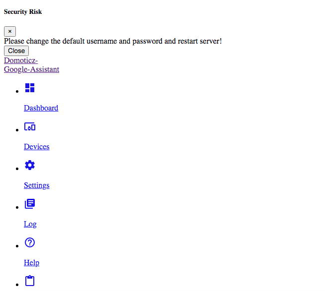

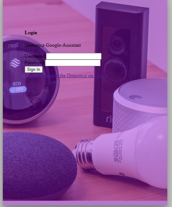

Guys, I have question concerning running DZGA behind Apache proxy, maybe somebody can help... I have setup the following in the apache conf:
<Location /projects/dzga/>
ProxyPass http://127.0.0.1:3030/
ProxyPassReverse http://127.0.0.1:3030/
</Location>
And I can access the login page and I can also login and setup domoticz IP etc. However, the number of connected Domoticz devices is always 0 although the DZGA tells me at startup that it is connected to Domoticz under 127.0.0.1:8080.
On the other hand, when I connect to DZGA directly via http://127.0.0.1:3030/settings and login, I see that the number of Domoticz devices is not zero, as it should be, and everything seems fine. In the apache log I can see the following:
AH00128: File does not exist: F:/NetworkIntranet/WEBSERVER/htdocs/log, referer: http://192.168.0.15/projects/dzga/setti ... =undefined
Herein "F:/NetworkIntranet/WEBSERVER/htdocs/log" is a directory under DocumentRoot "F:/NetworkIntranet/WEBSERVER/htdocs/" set in the Apache config.
Obviously, Apache cannot find the" F:/NetworkIntranet/WEBSERVER/htdocs/log" directory under the DocumentRoot. The question is why it is instructed to look there if there is a correct proxy setting?
Maybe somebody can provide a hint?

I have also an issue with the display when i tried to connect to Domoticz or DZGA with : https://....duckdns.org/Domoticz-Google-Assistant-settings
Do you know why ?
Capture d’écran 2020-12-06 à 23.39.14.png (38.39 KiB) Viewed 4411 times
Do you know why ?
Try with ngrok, mybe you can get it to work with that

Do you have any idea for this ? I have an issue with the display with http://toto.duckdns.org/Domoticz-Google ... t/settings
It works with http://localhost:3030/settings.
Capture d’écran 2020-12-07 201924.png (387.38 KiB) Viewed 4369 times
