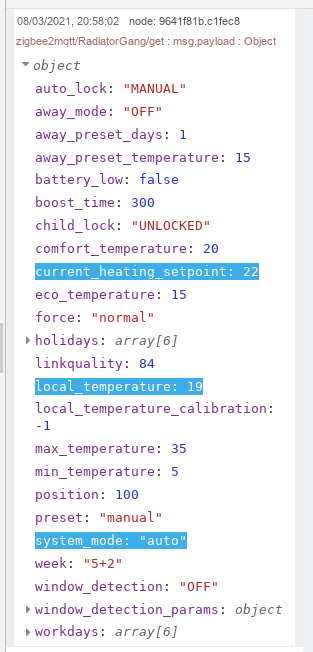

hello @edwin1234,
I put your code in a Node Red "Inject" node and that gives me the following output in a "Debug" node.
I assumed that the topic in this case is : zigbee2mqtt/RadiatorGang/get.

I made a first flow as follows:
If your topic is different, you may want to modify the topic in the MQTT Input node.Do not forget to configure your own MQTT server, which is currently set to 'localhost'.
Please find the complete flow below:
[{"id":"758cd1dd.afc4c","type":"tab","label":"Test Zigbee2MQTT Tuya Thermostat","disabled":false,"info":""},{"id":"e6ce71c0.0d18d8","type":"inject","z":"758cd1dd.afc4c","name":"","props":[{"p":"payload"},{"p":"topic","vt":"str"}],"repeat":"","crontab":"","once":false,"onceDelay":0.1,"topic":"zigbee2mqtt/RadiatorGang/get","payload":" {\"auto_lock\":\"MANUAL\",\"away_mode\":\"OFF\",\"away_preset_days\":1,\"away_preset_temperature\":15,\"battery_low\":false,\"boost_time\":300,\"child_lock\":\"UNLOCKED\",\"comfort_temperature\":20,\"current_heating_setpoint\":22,\"eco_temperature\":15,\"force\":\"normal\",\"holidays\":[{\"hour\":6,\"minute\":0,\"temperature\":20},{\"hour\":8,\"minute\":0,\"temperature\":15},{\"hour\":11,\"minute\":30,\"temperature\":15},{\"hour\":12,\"minute\":30,\"temperature\":15},{\"hour\":17,\"minute\":30,\"temperature\":20},{\"hour\":22,\"minute\":0,\"temperature\":15}],\"linkquality\":84,\"local_temperature\":19,\"local_temperature_calibration\":-1,\"max_temperature\":35,\"min_temperature\":5,\"position\":100,\"preset\":\"manual\",\"system_mode\":\"auto\",\"week\":\"5+2\",\"window_detection\":\"OFF\",\"window_detection_params\":{\"minutes\":196,\"temperature\":125},\"workdays\":[{\"hour\":6,\"minute\":0,\"temperature\":20},{\"hour\":8,\"minute\":0,\"temperature\":15},{\"hour\":11,\"minute\":30,\"temperature\":15},{\"hour\":12,\"minute\":30,\"temperature\":15},{\"hour\":17,\"minute\":30,\"temperature\":20},{\"hour\":22,\"minute\":0,\"temperature\":15}]}","payloadType":"json","x":210,"y":80,"wires":[["e0045a59.0ea4c"]]},{"id":"3aa46e6b.6dc2da","type":"function","z":"758cd1dd.afc4c","name":"Function In Thermostaat","func":"msg.payload = {\n    setpoint : msg.payload.current_heating_setpoint,\n    temperature : msg.payload.local_temperature,\n    mode : msg.payload.system_mode\n};\nreturn msg","outputs":1,"noerr":0,"initialize":"","finalize":"","x":410,"y":140,"wires":[["b2fc0b15.d933"]]},{"id":"feb24a85.ce41d8","type":"function","z":"758cd1dd.afc4c","name":"Function Out Thermostaat","func":"var msg1 = {};\nvar msg2 = {};\n\nmsg1.topic = \"zigbee2mqtt/RadiatorGang/set\";\nmsg1.payload = {\n    \"current_heating_setpoint\" : msg.payload.setpoint\n}\n\nmsg2.topic = \"zigbee2mqtt/RadiatorGang/set\";\nmsg2.payload = {\n    \"mode\" : msg.payload.mode\n}\n\nreturn [[msg1,msg2]];","outputs":1,"noerr":0,"initialize":"","finalize":"","x":960,"y":140,"wires":[["15cf31be.856ea6"]]},{"id":"e0045a59.0ea4c","type":"mqtt out","z":"758cd1dd.afc4c","name":"Out","topic":"","qos":"","retain":"","broker":"f9f13036.e28b58","x":370,"y":80,"wires":[]},{"id":"4bb52373.7cc4ac","type":"mqtt in","z":"758cd1dd.afc4c","name":"In","topic":"zigbee2mqtt/RadiatorGang/get","qos":"0","datatype":"json","broker":"f9f13036.e28b58","x":190,"y":140,"wires":[["3aa46e6b.6dc2da"]]},{"id":"b2fc0b15.d933","type":"nora-thermostat","z":"758cd1dd.afc4c","devicename":"Thermostaat","roomhint":"Gang","name":"Radiator Thermostaat","modes":"off,on,auto","unit":"C","topic":"","passthru":false,"commandOnly":false,"queryOnly":false,"bufferRangeCelsius":"2","nora":"6f52ea33.833a2c","x":680,"y":140,"wires":[["feb24a85.ce41d8"]]},{"id":"15cf31be.856ea6","type":"mqtt out","z":"758cd1dd.afc4c","name":"Out","topic":"","qos":"","retain":"","broker":"f9f13036.e28b58","x":1190,"y":140,"wires":[]},{"id":"f9f13036.e28b58","type":"mqtt-broker","name":"localhost","broker":"127.0.0.1","port":"1883","clientid":"","usetls":false,"compatmode":true,"keepalive":"60","cleansession":true,"birthTopic":"","birthQos":"0","birthRetain":"false","birthPayload":"","closeTopic":"","closeQos":"0","closePayload":"","willTopic":"","willQos":"0","willPayload":""},{"id":"6f52ea33.833a2c","type":"nora-config","d":true,"name":"Nora Config","group":"Mendelssohn92","notify":false}]

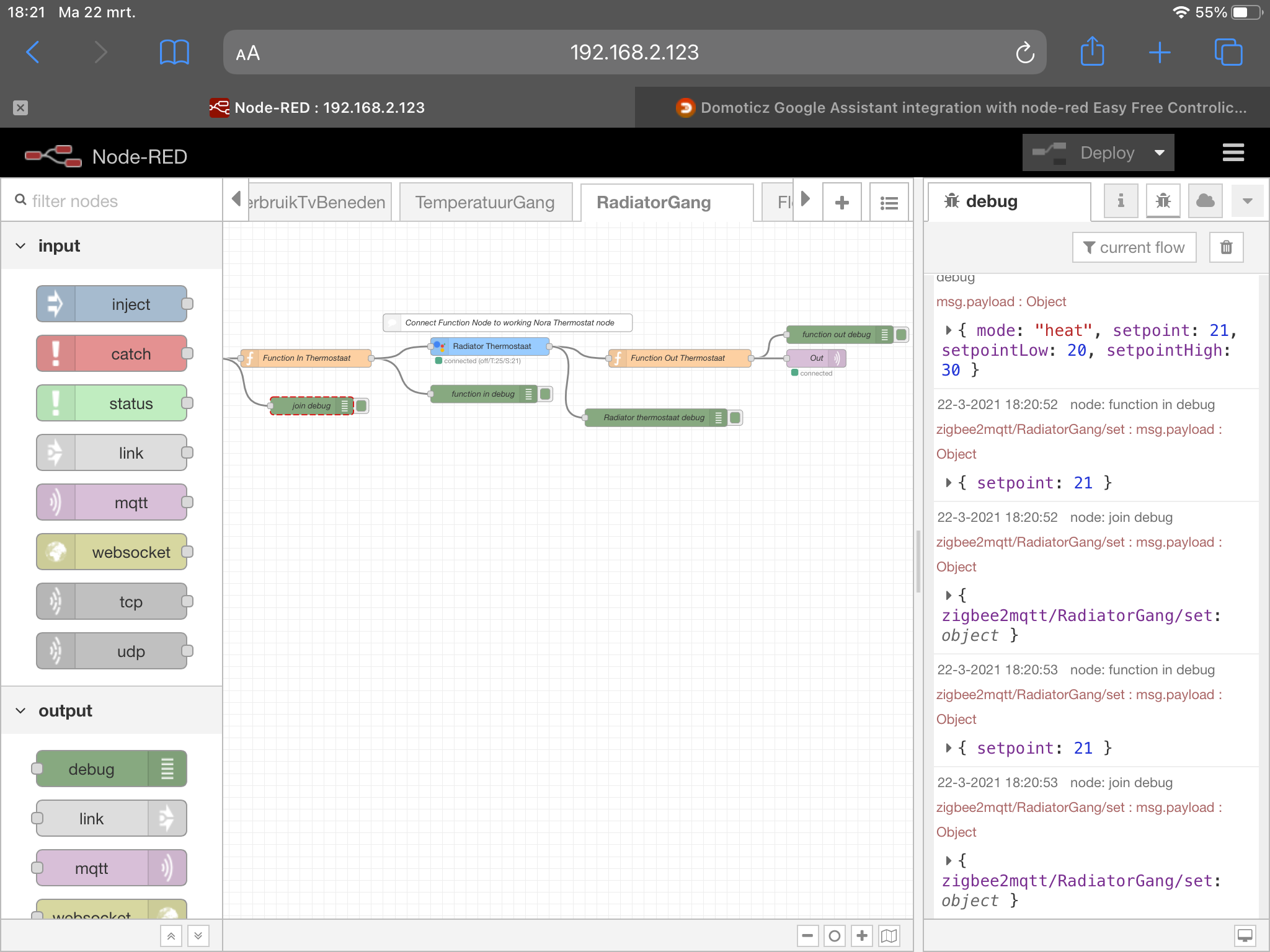

@ firewizzard
I have some light devices working with nora in google home,
The thermostat in my flow does not show connected like in your picture.
When i set temperature higher in domoticz the flow is:
 {"current_heating_setpoint": 21.0}
From topic zigbee2mqtt/RadiatorGang/set
And i get back thermostat topic zigbee2mqtt/RadiatorGang
 {"auto_lock":"MANUAL","away_mode":"OFF","away_preset_days":1,"away_preset_temperature":15,"battery_low":false,"boost_time":300,"child_lock":"UNLOCKED","comfort_temperature":20,"current_heating_setpoint":21,"eco_temperature":15,"force":"normal","holidays":[{"hour":6,"minute":0,"temperature":20},{"hour":8,"minute":0,"temperature":15},{"hour":11,"minute":30,"temperature":15},{"hour":12,"minute":30,"temperature":15},{"hour":17,"minute":30,"temperature":20},{"hour":22,"minute":0,"temperature":15}],"linkquality":84,"local_temperature":16,"local_temperature_calibration":-1,"max_temperature":35,"min_temperature":5,"position":100,"preset":"manual","system_mode":"auto","week":"5+2","window_detection":"OFF","window_detection_params":{"minutes":196,"temperature":125},"workdays":[{"hour":6,"minute":0,"temperature":20},{"hour":8,"minute":0,"temperature":15},{"hour":11,"minute":30,"temperature":15},{"hour":12,"minute":30,"temperature":15},{"hour":17,"minute":30,"temperature":20},{"hour":22,"minute":0,"temperature":15}]}
I added a debug node and i get no messages, but if i change zigbee2mqtt/RadiaterGang/get to zigbee2mqtt/RadiatorGang and change temperature on the thermostat itself i get the above output

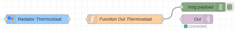

If you have finished your testing with the INPUT side of your Nora Thermostat node, can you try this at the OUTPUT side:
The output of the Nora Thermostat node should be connected to the input of the Function node and its output to the MQTT Output node.
Modify the following:
In the Function node:
- Replace in line 15 the IDX from 1234 to the IDX number of your Thermostat device in Domoticz.
- In the MQTT Output node.
- Configure your own MQTT sever (broker) Currently localhost
See below the complete flow:
[{"id":"15cf31be.856ea6","type":"mqtt out","z":"758cd1dd.afc4c","name":"Out","topic":"","qos":"","retain":"","broker":"","x":1190,"y":140,"wires":[]},{"id":"30cb6afc.2acf56","type":"function","z":"758cd1dd.afc4c","name":"Function Out Thermostaat","func":"var msg1 = {};\nvar msg2 = {};\nvar setpoint = msg.payload.setpoint;\nvar mode = msg.payload.mode;\n\nmsg1.topic = \"zigbee2mqtt/RadiatorGang/set\";\nmsg1.payload = {\n    \"current_heating_setpoint\": setpoint,\n    \"system_mode\": mode\n}\n\nmsg2.topic = \"domoticz/in\";\nmsg2.payload = {\n    \"command\":\"udevice\",\n    \"idx\":1234,\n    \"svalue\":setpoint.toString()\n}\n\nreturn [[msg1,msg2]];","outputs":1,"noerr":0,"initialize":"","finalize":"","x":960,"y":140,"wires":[["c43c7def.a8ef78"]]},{"id":"c43c7def.a8ef78","type":"debug","z":"758cd1dd.afc4c","name":"","active":true,"tosidebar":true,"console":false,"tostatus":false,"complete":"false","statusVal":"","statusType":"auto","x":1210,"y":100,"wires":[]}]
Let me know the result.

Hi firewizard,
I get an error on function in thermostat when i change the temperature in domoticz.
The error is : type error can not read property
Curent heating setpoin of undefinded
FireWizard
Posts: 1974
Location: Voorthuizen (NL)
Re: Domoticz Google Assistant integration with node-red Easy Free Controlicz alternative!
Post by FireWizard »
Hello Edwin (@edwin1234 )
Can you connect a "Debug" node to the output of the "Join" node and send a screenshot of what you see, if you operate the Domoticz thermostat?
What does happen if you operate your smart thermostat, which is connected to zigbee2mqtt?

I found indeed something strange, but would it be possible to provide a screenshot of the Debug node, next time? The provided bunch of text is very difficult to analyze.
Can you change the contents of the Function node, called "Function in Thermostaat" into:

Hello,firewizard
Here a (little bit late picture) of the error
When i change temperature in domoticz thermostat.
And I figured out if i click on the inject node then the local temperature gets updated ,
And when i change temerature with google there are no errors , the local temperature in google home doesnt get updated automatically and thats why the errors are there , i think
FireWizard

Hello @edwin1234
Sorry for the somewhat delayed response. Some other issue to solve with beta 13092 and 13102.
This picture shows a lot more than all the previous posts.
Could you try to put this in the Function node, called "Function in Thermostaat":
switch (msg.topic) {
    case "zigbee2mqtt/RadiatorGang/get":
    msg.payload = {
        setpoint : msg.payload["zigbee2mqtt/RadiatorGang/get"].current_heating_setpoint,
        temperature : msg.payload["zigbee2mqtt/RadiatorGang/get"].local_temperature,
        mode : msg.payload["zigbee2mqtt/RadiatorGang/get"].system_mode
break;
    case "zigbee2mqtt/RadiatorGang/set":
    msg.payload = {
        setpoint : msg.payload["zigbee2mqtt/RadiatorGang/set"].current_heating_setpoint
break;
return msg
And report back, what happens if you test both from Domoticz to Google Home and from your thermostat to Google Home.
Also, what do you see in your Google Home app and the text below the Nora node, called "Radiator Thermostaat".
