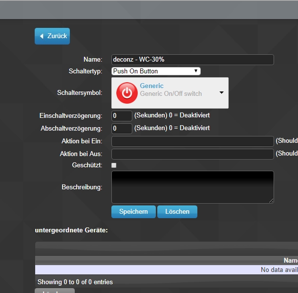

Good morning, I have a question: in Deconz I have a scene (3 lights to 30%). In Domoticz the plug-in shows the group, but if I want to turn it on, there will always be an error.
2019-06-22 07:57:34.365 (deconz) onCommand called for Unit 67: Parameter 'On', Level: 0, Hue:
2019-06-22 07:57:34.361 Status: User: Admin initiated a switch command (2435/deconz - WC-30%/On)
2019-06-22 07:57:34.395 Error: (deconz) Connexion problem (1) with Gateway : 404

Good morning too, (yeah I know , I wake up realy late), was a bug , again, corrected on master.
I m good to make a new master, too much bugs.

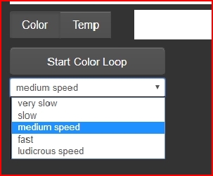

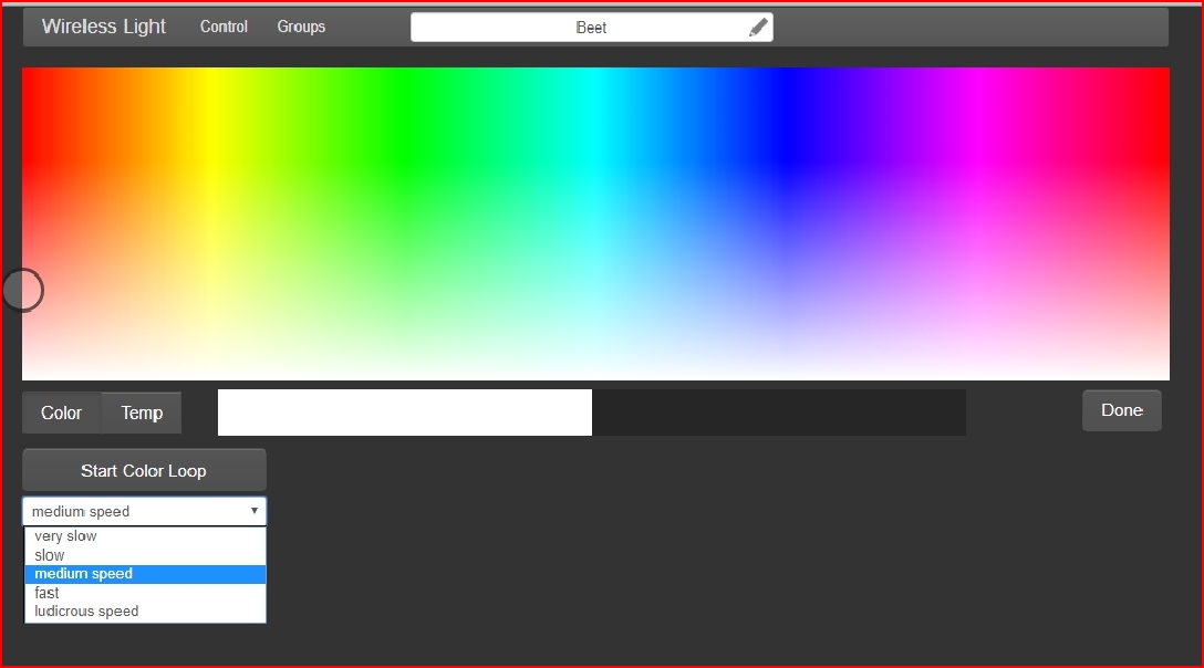

Hi, is it possible to implement the control of Colorloop, Speed into your plugin?
That would be cool!!
I have found in Domoticz no suitable solution for me, the z.b. the light always changes the colors in the rainbow after switching on, indefinitely.
Thorgal789
Posts: 920
Re: Python Zigbee plugin, deCONZ bridge (Using Conbee or Raspbee)
Post by Thorgal789 »
I think more or less.
Only some bulb support this features and ikea one not. Wich one bulb have you ?
If you have bulb that support that (and I think yes, with your screenshoot), there is lot of way to do that.
1 - with command line (like this one https://github.com/Smanar/Domoticz-deCO ... on-the-fly. ) I can make the command if you want to test.
2 - with scene editor in phoscon with a real switch
3 - with scene editor in phoscon with a fake switch
Idk yet what to do with that, but if you have the good bulbs, I can explain you how to make a switch in domoticz to launch a color cycle with some settings, using the solution 1.
