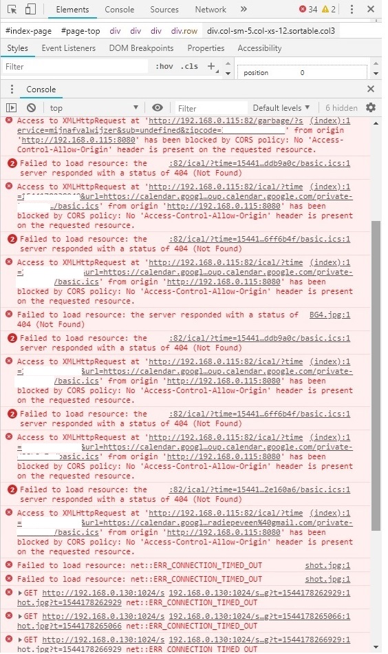

I removed the symlink and made the new one, that worked, so http://192.168.0.115/dashticz_v2/index.html shows dashticz.
However, both the garbage collector and calendar show loading...
The attachment inspection.jpg is no longer available

Re: IMPORTANT REQUEST!!!
Posted: Friday 07 December 2018 15:10
by Lokonli
nosehook wrote: Friday 07 December 2018 11:44 inspection.jpg
In the error-log I see references to 192.168.0.115:82, which is not good.
Do you still have a setting for php_path in your CONFIG.js? You can remove it.
With the CORS errors I see the request comes from 192.168.0.115:8080. This is however your Domoticz server which is not correct.
Can you try again with opening Dashticz via the default port 80:
(http://192.168.0.115/dashticz_v2)
Can you report the errorlog after making the two changes?
The CORS error still is strange, and should have been fixed with beta 2.4.5 onwards. Which Dashticz version are you using? (Press the settings icon in the top bar and then the info tab)

    at i (jquery.min.js:2)
    at Object.fireWith [as resolveWith] (jquery.min.js:2)
    at z (jquery.min.js:4)
    at XMLHttpRequest.<anonymous> (jquery.min.js:4)
getStatusBlock @ VM2574:483
handleDevice @ main.js?v=1545647766741:1373
success @ main.js?v=1545647766741:1256
i @ jquery.min.js:2
fireWith @ jquery.min.js:2
z @ jquery.min.js:4
(anonymous) @ jquery.min.js:4
load (async)
send @ jquery.min.js:4
ajax @ jquery.min.js:4
n.(anonymous function) @ jquery.min.js:4
getDevices @ main.js?v=1545647766741:1076
getDevicesTmr @ main.js?v=1545647766741:1311
(anonymous) @ main.js?v=1545647766741:1319
Any Advise?
