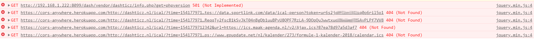

Hi guys,
My beatiful dashboard also ran into issues regarding the calendars...
And they worked so wel...
As a Linux Noob I have read this thread a couple of times and made the adjustments that were suggested.
Unfortunately I cannot get it to work. If I try to debug it this is what I get:
The first error seems to be a bit odd - I have PHP 70 running... What does the 501 Error mean?
I hope that I did not something stupid but sometimes the replies to this thread are contradictionairy so it's hard to find the truth.
But it is out there!
Thanks for al your efforts helping people out :-)
Theo.

The first error shows that php is not running. Are the IP and port address correct? Is 192.168.1.222:8099 your Domoticz server or your web server with PHP support?
The other three lines show a reference to dashticz.nl, which will not work, because dashticz.nl is down, and is not used anymore in the latest beta. Did you enter this somewhere manually in your CONFIG.js? You can remove the herokuapp part and the dashticz.nl part.
