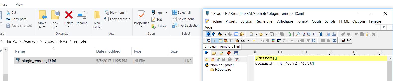

by Moulders
I'm still struggling with the ini files.. can anyone provide an example of theirs so I can compare?
Re: Python Plugin: Broadlink RM2
Posted: Monday 07 August 2017 23:30
by zak45
Moulders wrote:I'm still struggling with the ini files.. can anyone provide an example of theirs so I can compare?
here is mine:
this is an example of ini need to be created for remote customization
Others ini files are created automatically during learn/import process.
