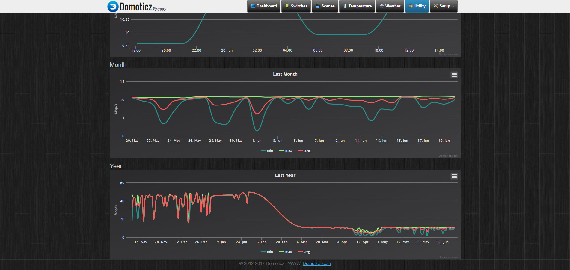

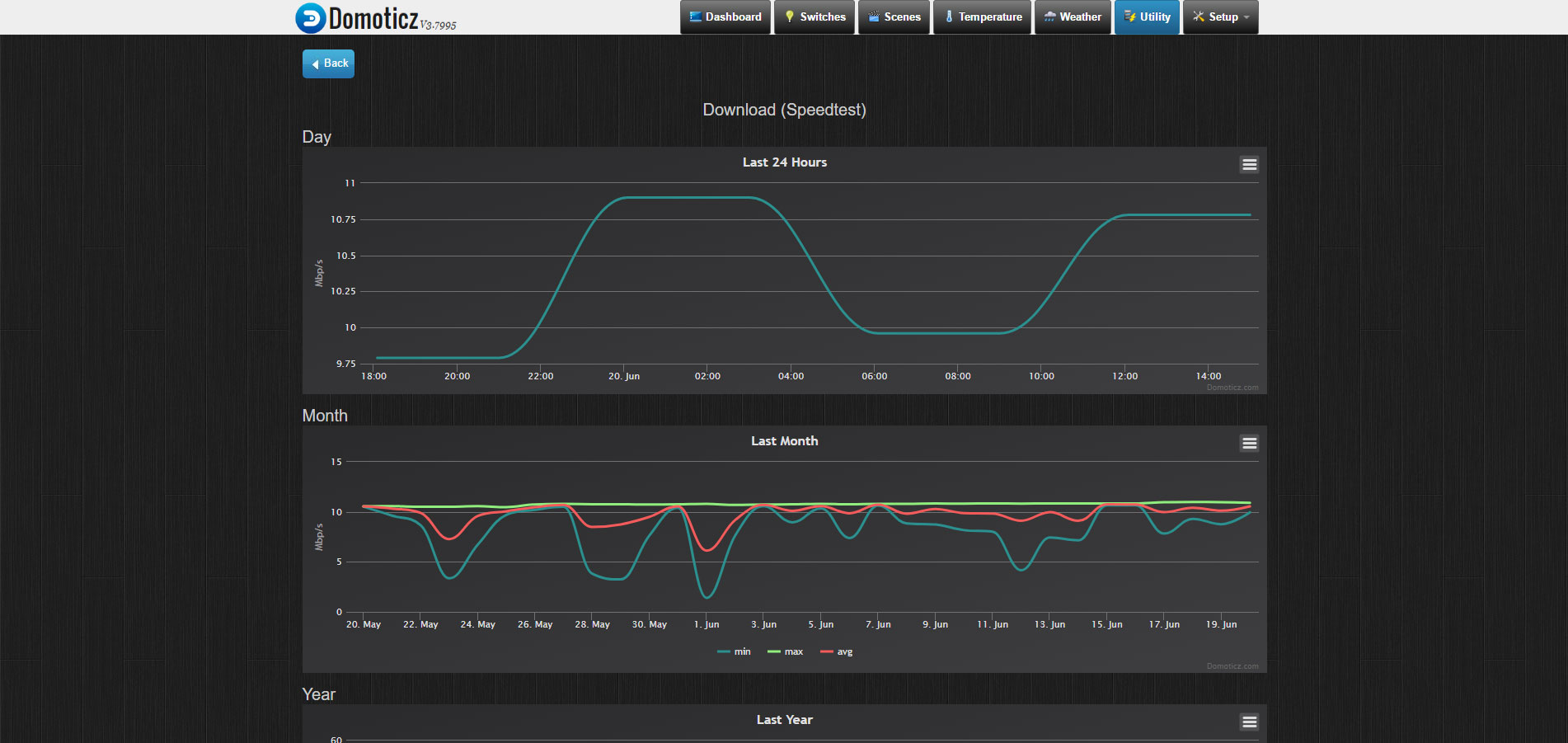

I'm really happy with the speed monitoring, it's been running since last year.
Download speed:
(Big drop off in speed moving from Hamburg, Germany to Brisbane, Australia)

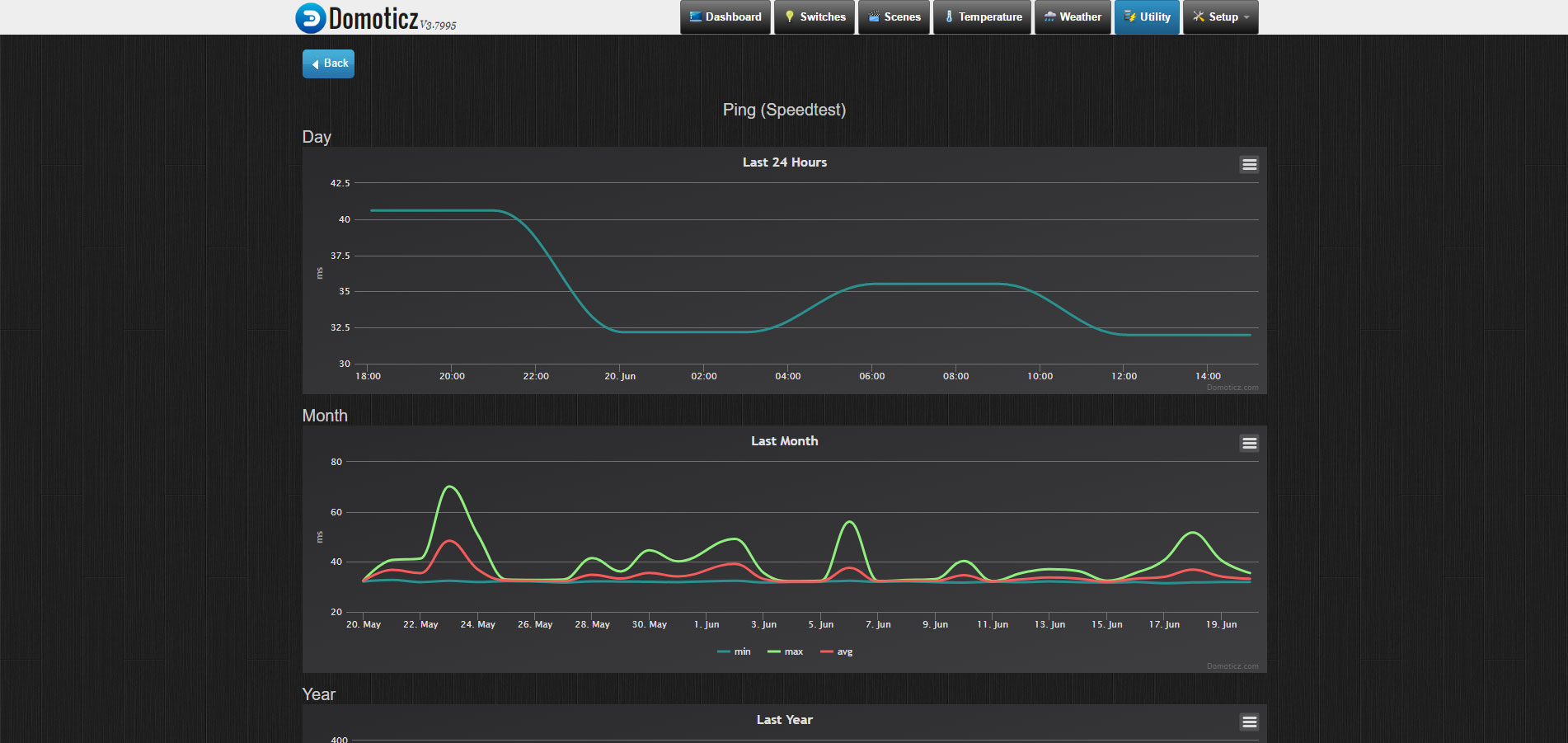

Ping:
