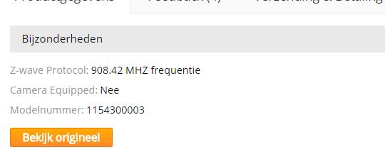

Derik wrote:there is zwave in the details....
So i try this one... [ perhaps.. ]
When it is not Zwave i get my money back.. ]
Only i do not understand what you are say about the Zigbee....
Domoticz accept a lot of protocols...
Only not zigbee.[ i buy a usb stick that is not the problem ]
I the Zigbee not good/stable enough for Domoticz?
Xiaomi is not into z-wave. You should never trust aliexpress desciptions, or at least do a google or visit the official websitr of the manufacturer. Also, the frequency mentioned on your screenshot is not for EU - but it's irrelevant since Xiaomi is using either zigbee or a propietary format (which is not open sourced).
My advice: save your money and buy something really supported by Domoticz.
I hope you do notice that this ain't EU frequence right?
Yeah i know....
Got my money back and support it to the RFlink developer..... ;)
Perhaps....
