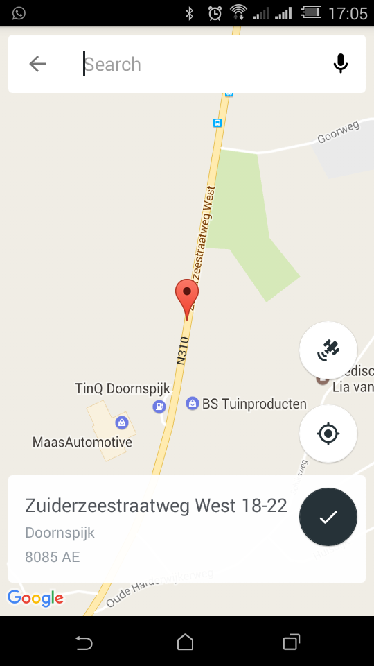

Gerwin
Posts: 84
Joined: Friday 12 August 2016 13:08
Re: Domoticz app 2.0
Post by Gerwin »
See picture
