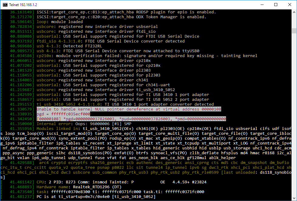

Just in case this might help, here's the dmesg result
Thanks,
Philippe
Thanks for your support. As you expected, the version for the ArmadaXP is working, but the rtd1296 is not working. Maybe this will help you, but when you connect the HGI80 on the DS118 after the DS118 was started normally, the whole DS118 completely freezes. The only solution is to cut power to the DS118, disconnect the HGI80 and restart.
If the HGI80 is connected before booting the DS118, It won't crash, but in Domoticz no ports can be assigned to the HGI80.
Thanks,
Philippe
