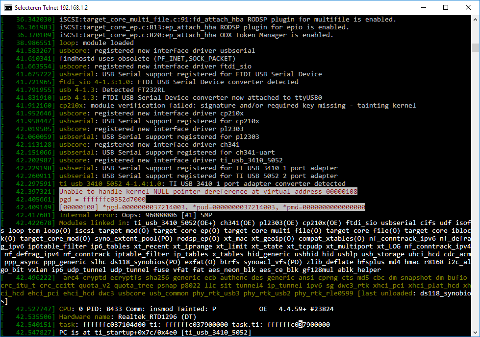

Hello Jumbotroll,
It seems I have some issues regarding the USB1 port where my evohome (HGI/S80) gateway is connected. I'm pretty sure that the problems started with a Synology update about four weeks ago, I did not worry about this, because most problems are usually fixed with a Domoticz update. Unfortunately, all updates so far have not resolved the connection problem with the HGI/S80 interface.
Model: DS118, Realtek RTD1296 SoC
Synology version: DSM 6.2.1-23824 Update 1
Domoticz version: V4.10119-7
I did notice that when Domoticz is running, the Synology Info Center, "General" tab would remains empty. After stopping Domoticz and restarting Synology, the "general" tab shows all synology information, including Evohome USB device: TUSB3410 Boot Device - Honeywell, Inc.
Hope you can help me out, thanks in advance,
Philippe

I don't think there is any changes in domoticz source with HGI/S80, so I am not sure what causes this problem.PhilippeDom wrote: Wednesday 31 October 2018 15:44 Hello Jumbotroll,
Philippe
Did you try to do a complete reinstall of domoticz package?
Take backup of domoticz.db and uninstall domoticz and reinstall.
I don't use HGI/S80 so I can't test it.

I did uninstall and install Domoticz, but the problem remains the same. I don't think the (HGI/S80) is the problem, but USB port is not initialized correctly.
Is it possible that the USB driver with Domoticz is not supported with my synology update?
Tx. Philippe
Tx. Philippe

Maybe USB driver change?PhilippeDom wrote: Thursday 01 November 2018 16:01 I did uninstall and install Domoticz, but the problem remains the same. I don't think the (HGI/S80) is the problem, but USB port is not initialized correctly.
Tx. Philippe
Did this happend when update from DSM 6.1 to DSM 6.2 ??
Please log in with Telnet or SSH and Type: dmesg
Check if there is any error with drivers and copy/paste result here..

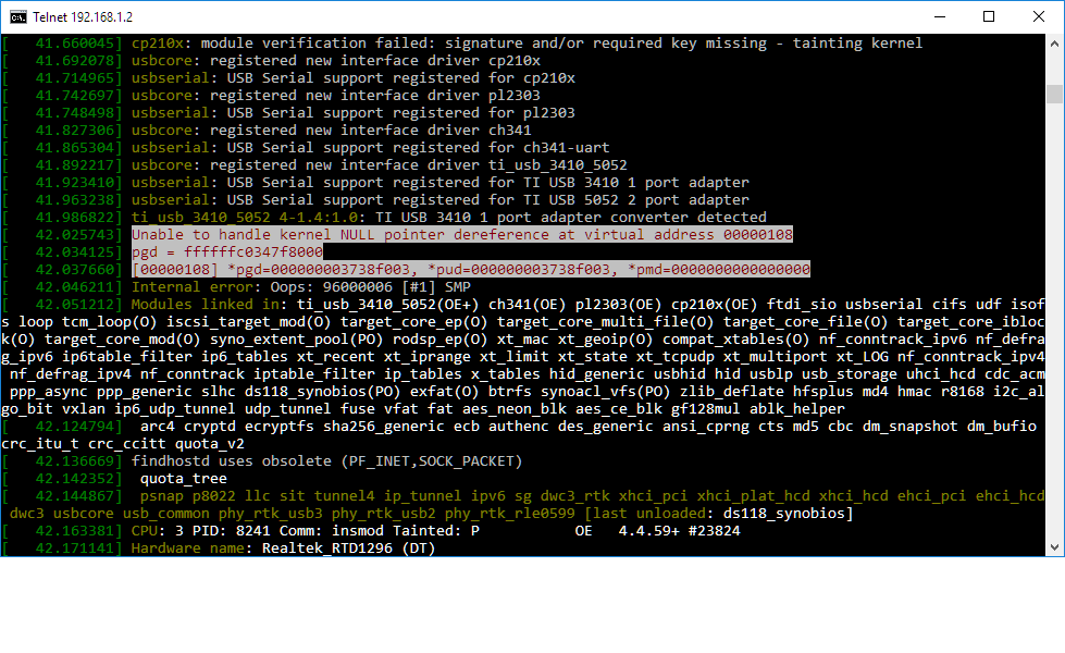

Here's the dmesg. I hope that you can figure this out. Tx, Philippe

PhilippeDom
- Posts: 11
- Joined: Tuesday 12 December 2017 18:40
- Domoticz version: 3.0.8770
Re: domoticz in synology as package! Available now.
Hi Jumbotroll,
Unfortunately, this update pkg (domoticz_rtd1296-6.2_4.0.10181-7.spk) did not fix the problem. I did uninstall Domoticz, reinstall the new version and reloaded the last backup. Then I restarted the system multiple times, somtimes with Domoticz started and sometimes stopped, but the result and Dmesg message is still the same, and from within domoticz, I'm still not able to find the USB port where the HGI80 is connected. I've attached the dmesg log.
Thanks for the support, it's appreciated.
jumbotroll wrote: Saturday 10 November 2018 12:28The vendor id was added in arch-rtd1296 kernel, so this is a different bug.PhilippeDom wrote: Saturday 10 November 2018 11:35 Hi Jumbotroll,
Is it possible to also update the RTD1296? I think that I have the same problem as David.
Tx. Philippe
I have found some code change in this driver for linux kernel 4.4.58 for rtd-1296 and will try to fix it.
I will give you a link to a updated domoticz build in 20 min here for you to test.
If this don't work, I don't know if I can fix this for you..
Edit:
USB: serial: ti_usb_3410_5052: fix array underflow in completion handler on linux kernel 4.4.58.
Test the latest build and before you install, please uninstall old domoticz and if you have installed USBSerial package remove this and only install the latest domoticz build.
http://www.jadahl.com/domoticz_beta_6.2/
- dmsg1.png (35.28 KiB) Viewed 2510 times
- jumbotroll
- Posts: 793
- Joined: Tuesday 13 January 2015 14:36
- Location: Oslo,Norway
Hmm .. I have no clue what this may be.PhilippeDom wrote: Saturday 10 November 2018 15:35 Hi Jumbotroll,
I see that this NAS only has 1GB of memory and maybe you have other applications that require a lot of memory and that it therefore crashes.
Try and stop other applications that might require a lot of memory and restart NAS. No other arch-rtd1296 users have reported this problem, so it may be a combination of software / hardware issues?
If you are using USB HUB, try unplugging this.
