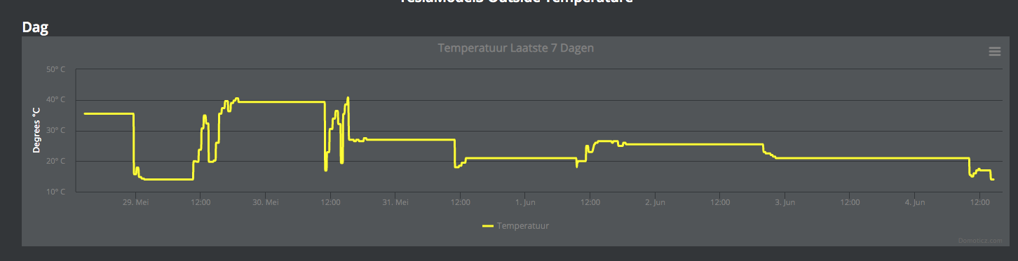

I guess there is indeed something with either you API-connection or the sensors. Is is the chart for the charge level OK?
You could also check this to see what e.g. TeslaFi is reporting.
Below is my chart:
