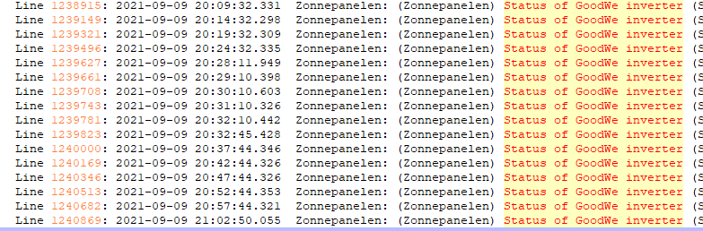

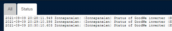

Well on my RPi 3 I do not have the issue with the update time, it behaves as expected:
1 minute setting (at 20:28):
5 minute setting (at 20:32);
log 1 and 5 minutes
log 1 and 5 minutes
log 1 5 minute.PNG (39.82 KiB) Viewed 3203 times
The code just counts down how often onHeartbeat is called. It could be that the heartbeat routine is called too often? I do not influence that from the plugin (although it is/should be possible to do so but in other plugins I found that that mechanism doesn't work).
Do you have other plugins where you can try this on?
In the meantime I also made some smaller updates to the plugin on error handling.

Post by bldewit »
JanJaap wrote:OK, so some remarks here:
  • the time-out errors are not really a problem. The data is fetched during the next pol, error can be ignored.
  • the input devices only provide the power (in Watt), not the generated energy (in kWh). This information is not provided by SEMS
  • the test device is a test for me to calculate the generated energy in kWh by multiplying the power by the elapsed time, so that I can resolve the previous point. However the multiplication is not correct (yet). It needs to take into account the missed polls, for example and then still it will be an estimate since the actual power is not averaged over the polled time. SEMS by default only updates the values once per 5 minutes, so a lot of clouds could be passing by in that time.
So all in all, your plugin works as how I expect it to work 8-)
Thank god (and you) Image
