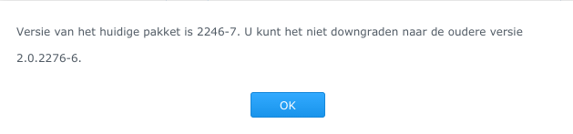

Trying to upgrade manually, but it won't.
Screenshot 2015-03-20 at 22.30.02.png (8.65 KiB) Viewed 4433 times
It should be a newer version, or not?

@mschut
Decipher wrote:At some point the numbering of the SynoCommunity changed to more closely reflect that of the numbering in the Domoticz history file. The Syno sees 2.0.2276-6 to be an earlier version number than 2246-7.
I was not involved with this project at that time, it just is what it is. The simplest solution is to backup your Domoticz DB, uninstall and reinstall.
This helped me to sort out the version problems. I had to re-boot my Syno between reinstalls, otherwise it failed to install Domoticz!

I performed the upgrade by uninstalling and installing manually. The first thing my Synology said, was that I should upgrade the domoticz package. Guess what. It did the upgrade to the previous version.

by Eternity
Yes, that is what happens (if you don't read)...
A couple of post up on this page I quoted Decipher and his explanation of the new version numbering.
Your Syno thinks it can upgrade Domoticz, but downgrades. This is due to the altered history numbering. Hopefully this will get sorted out soon. In the meantime you could upgrade mnanually (backup and restore your database) and ignore the update message.
