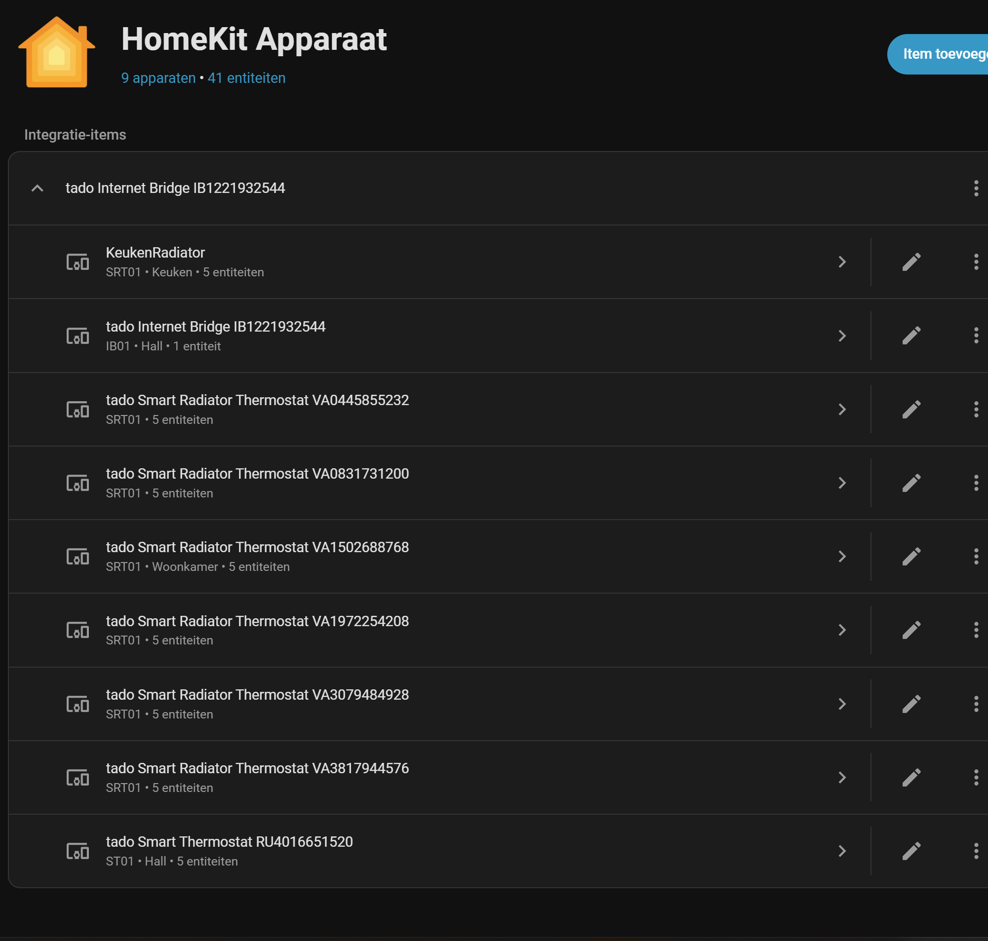

This uses the homekit integration in HomeAssistant, does everything local, No internet needed.. So no whorries about #queries....
But the mqtt topic/messages are published to a separte MQTT broker. The messages are getting into MQTT, but DZ does not import new devices.
So could this be a MQTT-AD issue in DZ?
I've created automations in HA, they are working. But I would love to see this work again in DZ too.
See attachments in previous post please

- 2025-10-22_15-39-39.png (232.91 KiB) Viewed 3724 times

I do not own any Apple device...
Just reset the bridge... put it in pairing mode, HA homekit add on will detect it... insert the pairing code from the bridge into HA, all devices will be found and added in HA .... it is that simple
I did end my TADO account and removed the app from my phone, my next payment was due today... Also restricted all *.tado domains from my network using PiHole...
