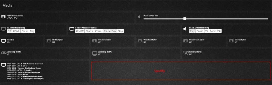

Is there any way to customize only the width of the spotify block?
I have a existing block like this:
columns[4] = {}
columns[4]['blocks'] = ['blocktitle_5',1000,1073,344,520,1001,1021,1023,1025,1024,1122,1018,1019,1020,1119,tvguide.dutch,'spotify']
columns[4]['width'] = 12;
I would like to have the spotify block next to the tvguid block that has a width of 4. The spotify block must also have the width of 8.
With this above setting the spotify block is always 12 (like the last width config from the columns). Now the spotify block is under the tvguide.
Screenshot:
