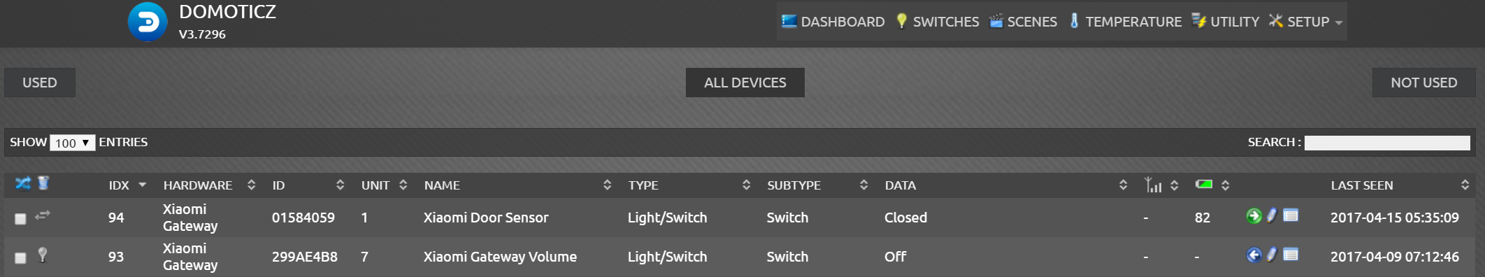

StefanoA wrote:
Image[/url]
can the problem be related to some kernel/system version or configuration ?
Very likely it is your Raspberry Pi configuration. I don't know why iptables would not be available on your system... my stock install on Pi3:

mvveelen wrote:@corbin:
Another issue I mentioned: after a new update of Domoticz, and while all doors where closed, the statuses of the door sensors where wrong. In Domoticz the status was 'open' and that's not the last status Domoticz received from the sensors, so there might be something wrong there too.
Would be nice if other users could check this so you know where to look for the bug :) ?
Hi, I have checked this and I confirm that the status after an update is open although the physical state is closed.
I hope this can be changed since many actions in my automationplan are depending on door states and it would be lot of alarm and lights when after a update all the states will be open :-)
Best regards Bert

Is there a specific reason why you don't have the separate battery statuses under "Utility" ? I was happy with that solution, but somehow you deleted it. Maybe you have good reasons so I can understand why :) ?
All battery statuses are back now. Don't know if that closed/open status will be OK next time I update Domoticz, but if it's not, I will send you my domoticz.db 8-)
Oops, I just read bertigb's reply and see that I'm not the only one with wrong closed/open statuses after restarting Domoticz. Perhaps some small bug in the code?
Edit:
I see this in my log:
2017-04-15 11:45:58.200 {"cmd":"heartbeat","model":"magnet","sid":"158d0001191a13","short_id":2787,"data":"{\"voltage\":3065,\"status\":\"open\"}"}
Status open ?? The sensor is closed and also the status in Domoticz remains closed. Is this normal behaviour or a lead to the bug in the code :) ?
