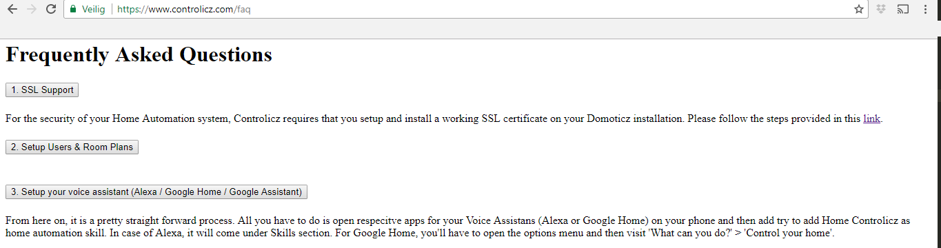

Excellent the FAQ is working.
When I started the day before yesterday the numer 2 did not play the nice instruction video. Showed just an icon of missing something.
And while searching the web I could find this.

I upgraded the site yesterday.

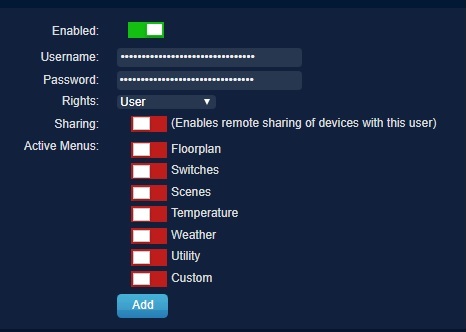

Currently for me SCENES and GROUPS don't show up yet (added to roomplan: yes).
Even with the Sharing and Scenes tab enabled for the user.
The user has access to the menus if i login with the specific user.

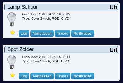

I can't control 'Lamp Schuur' and 'Spot Zolder'. Please help :)

They should be lights, yes:
Screenshot 2018-04-29 at 15.41.12.png (31.54 KiB) Viewed 2716 times
Type: Color Switch - SubType: RGB - Added as: On/Off, so I like it as On/Off in Controlicz aswell

Akerboom wrote: Sunday 29 April 2018 15:43 They should be lights, yes:
try now

Madgeni wrote: Sunday 29 April 2018 15:56 try now
Awesome, working: lights show up in Google Assistant and can be controlled!
