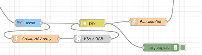

With the "Google Home" node from the "node-red-contrib-cast" library I got it to work.
Thank you!
Below a screenshot if people are interested:
Thanks for your quick response!
Thank you!

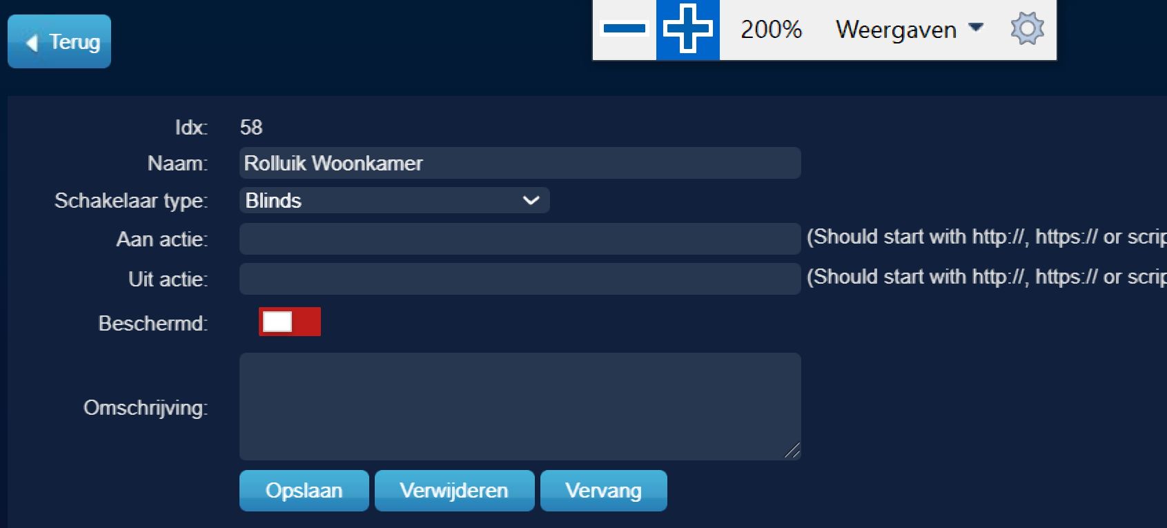

@FireWizard
In Domoticz the "Blinds" switch has no percentages.
I have made a screenshot of the switch. (i don't use the "Blinds Percentage" switch, is that the problem?)
If this is not what you mean please let me know!

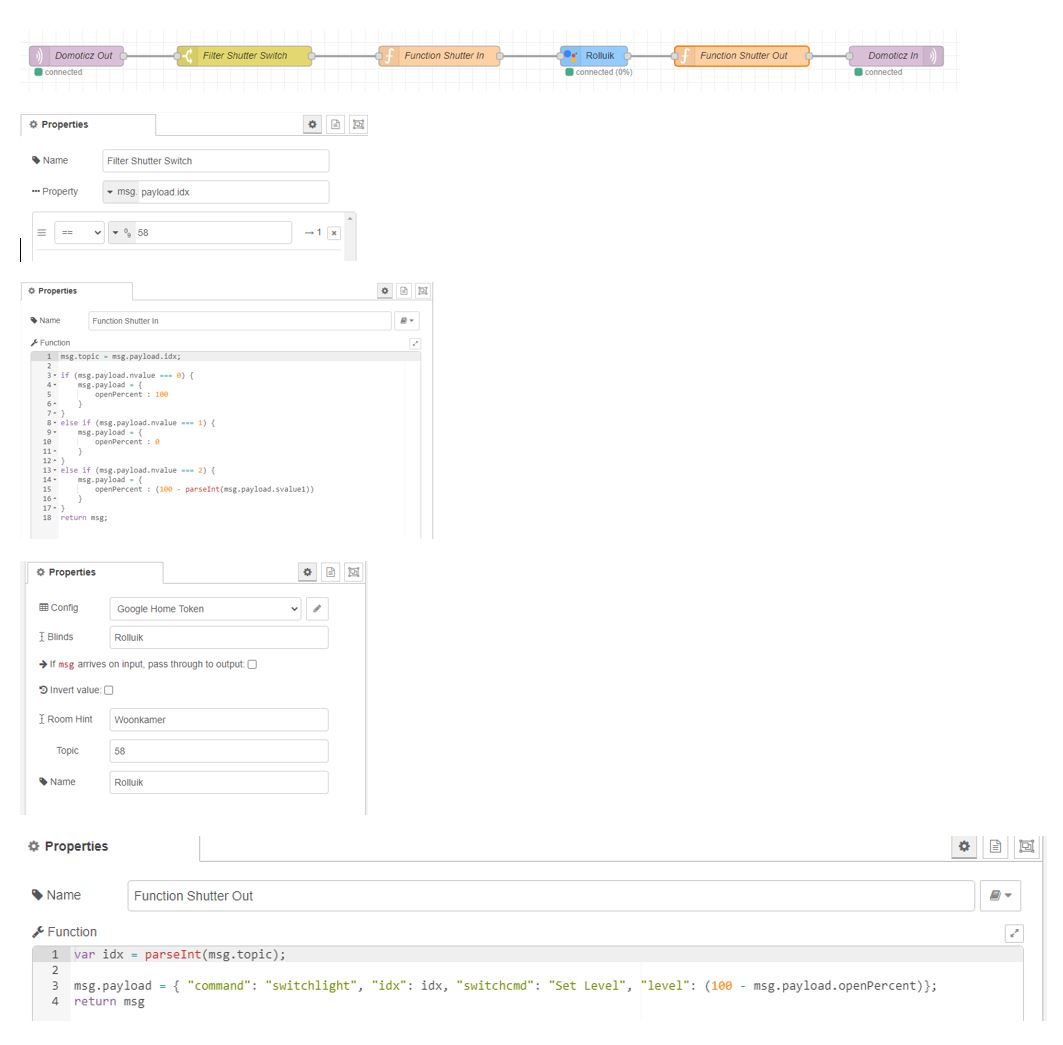

@atmfrenki
I have modified the "Function" nodes, according to the "Switch" type, you use.
The previous code doesn't work with your "Switch" type (Blinds)
Please, try the following code as input into the "Nora" node (type "blinds").
It might be necessary to modify the "Split" node, called "Filter Shutter Switch" and to give in the right IDX number (currently 58).
Find below the code for the output from the "Nora" node to Domoticz.
I have a question, just curiosity. How do you you handle, let's say 50% (or whatever, what value) open of the Blinds with a KAKU ASUN-650 switch?
Or isn't that possible?
Awaiting you results.

atmfrenki
- Posts: 25
- Joined: Monday 17 April 2017 13:57
Re: Domoticz Google Assistant integration with node-red Easy Free Controlicz alternative!
@FireWizard
Thanks for the solution, works like a charm!
The Asun-650 doesn't work with percentages.
I tried it, changed the devicetype in domoticz, but than it does not work anymore.
When I want the shutter half open I have to use the same command again to open or close, than it stops the shutter from closing or further opening.
You can call it a dumb "smart switch" .
Thanks for the Help!

Can you connect a "Debug" node, as shown in the screenshot below and return the result.
Perhaps you can also connect a "Debug" node at the same place in a working flow and compare results.
