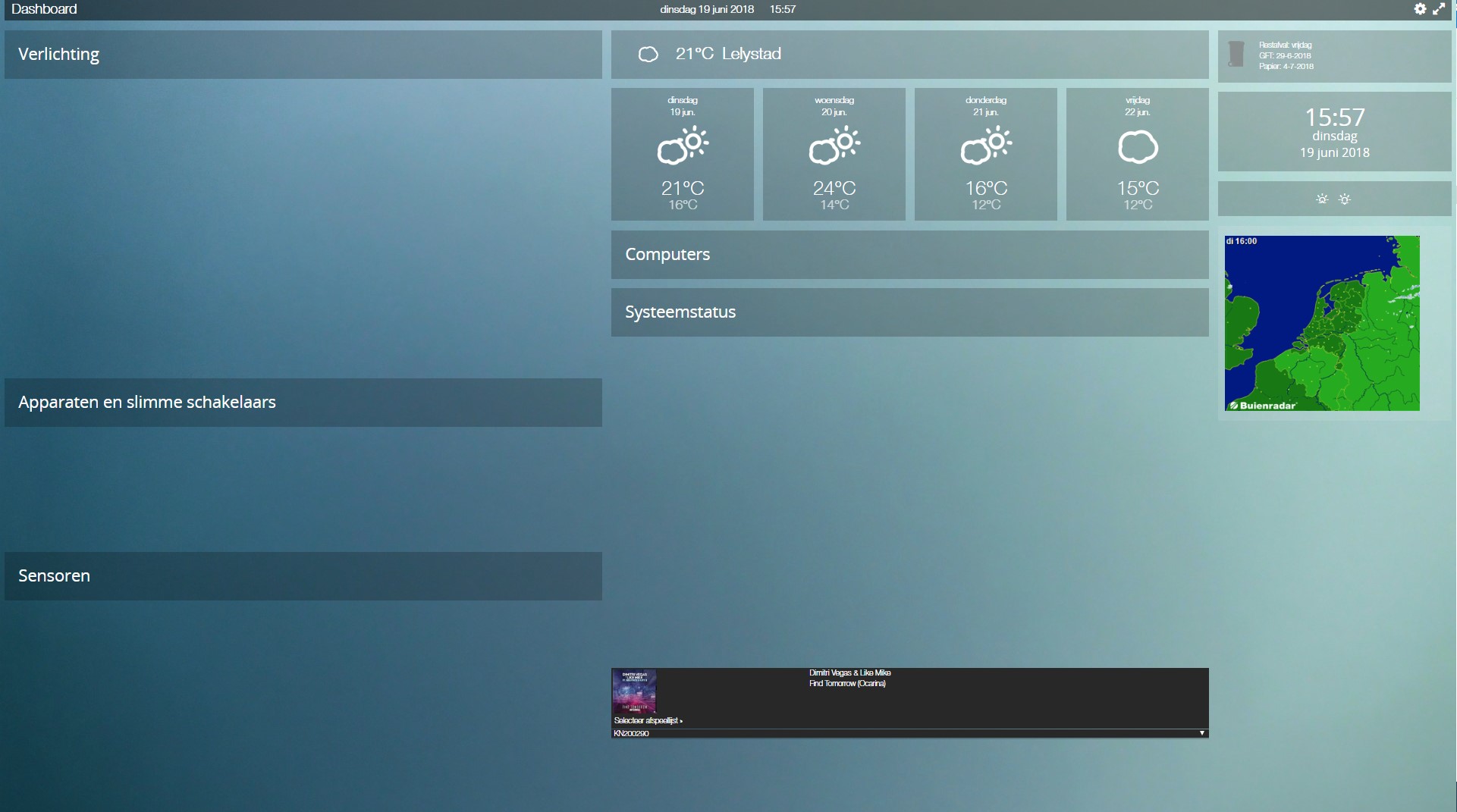

hi there,
as soon is i insert the 'spotify' to one of my pages the connection with domotcz is gone.
Meaning that there is no connection with all of the lights i putt in there,
can sombody help me?

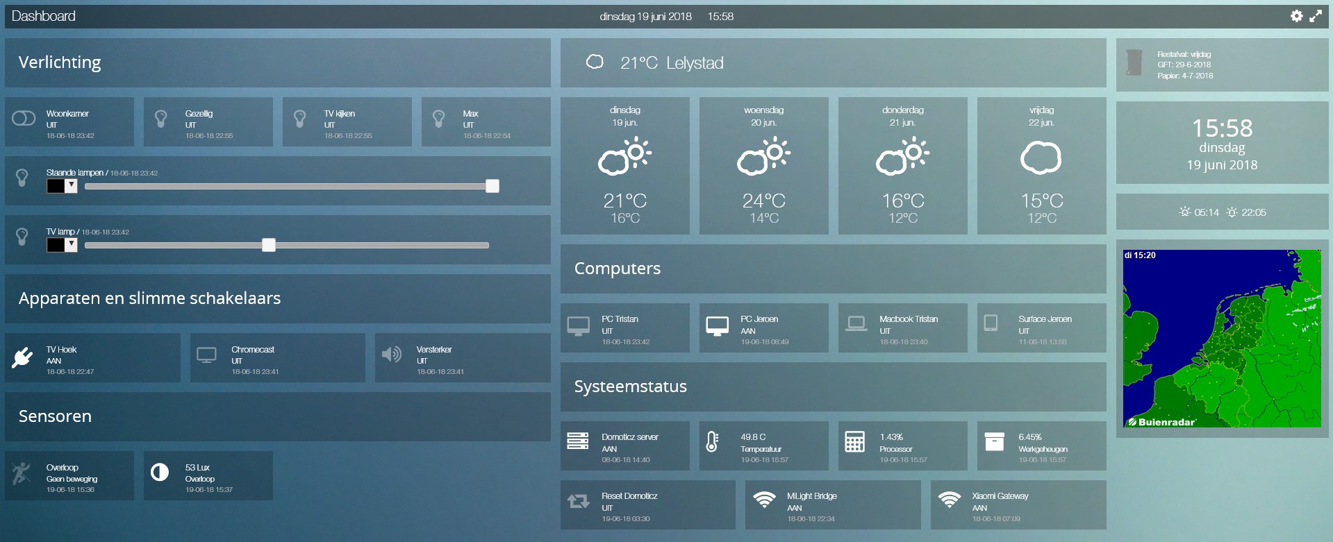

Re: Dashticz - Module - Spotify (new version!)
Posted: Tuesday 19 June 2018 16:01
by tristanp
Hi Rob,
For some reason adding 'spotify' breaks my Dashticz.
See attached screenshots.
I am on the latest BETA.
without spotify.jpg (222.32 KiB) Viewed 6268 times
with spotify.jpg (188.87 KiB) Viewed 6268 times
Do you have a solution for this?
THANKS, I absolutely love Dashticz.
Posted: Wednesday 20 June 2018 22:19
by Lokonli
tristanp wrote: Tuesday 19 June 2018 16:01 Hi Rob,
Which browser/OS do you use?
Posted: Wednesday 20 June 2018 23:14
by tristanp
Lokonli wrote: Wednesday 20 June 2018 22:19
This is Chrome on a Windows 10 X64.
I have also tried Chrome and Safari on Mac OS X High Sierra.
Posted: Wednesday 20 June 2018 23:27
by Lokonli
Which version of Dashticz is reported by Dashticz in Settings->info?
Posted: Friday 22 June 2018 9:01
by tristanp
Lokonli wrote: Wednesday 20 June 2018 23:27 Which version of Dashticz is reported by Dashticz in Settings->info?
Version 2.3.3 Master.
Posted: Friday 22 June 2018 21:02
by Lokonli
tristanp wrote: Friday 22 June 2018 9:01
Spotify has a bug in master. Try the latest beta.

Ok, got the right url, it was http and not https. Go figure, as simple as that like it most of the times is.
Next problem, when I put in the block for spotify it pushes away everything
Got a blank Dashticz dashboard.........no info from Domoticz and no info from Spotify,
Code:
var config = {}
config['domoticz_ip'] = 'http:/id:[email protected].***:****';
config['spot_clientid'] = '**********************'
var columns = {}
columns[1] = {}
columns[1]['blocks'] = ['spotify']
columns[1]['width'] = 5;
Edit 2:
Discovered the fault myselves, missing ; behind the spotify clientid.
Now I have the spotify blocks but that is the only thing showing on the Dashboard.
If I remove the column for spotify in the code then everything else is visible..........
Edit 3:
Got it working so far, if you just keep searching and trail and error you can get very far.
Now got my switches in the dashboard together with spotify clock and sunset.
So working from here.
