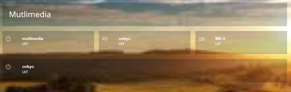

Very happy with Dashticz V2.0 Thnx for that!
But now i encounter an issue wich i don't know if it is resolved or not (could not find it searching this topic)
I have a button and a Scene , Botch have IDX2
blocks[2] = {}
blocks[2]['width'] = 4;
blocks[2]['title'] = 'onkyo'
blocks[2]['icon'] = 'fa-volume-up';
in Config.js i already renamed the Scene :
blocks['s2'] = {}
blocks['s2']['type'] = 'Scene';
blocks['s2']['width'] = 12;
blocks['s2']['title'] = 'Alles uit'
blocks['s2']['icon'] = 'fa-power-off';
But still the scene has the same name as the power button and i haven't figured out why.
2017-04-18 16_15_55-Microsoft Edge.png (302.93 KiB) Viewed 2857 times
Hope someone can helpme getting back on the right track :)

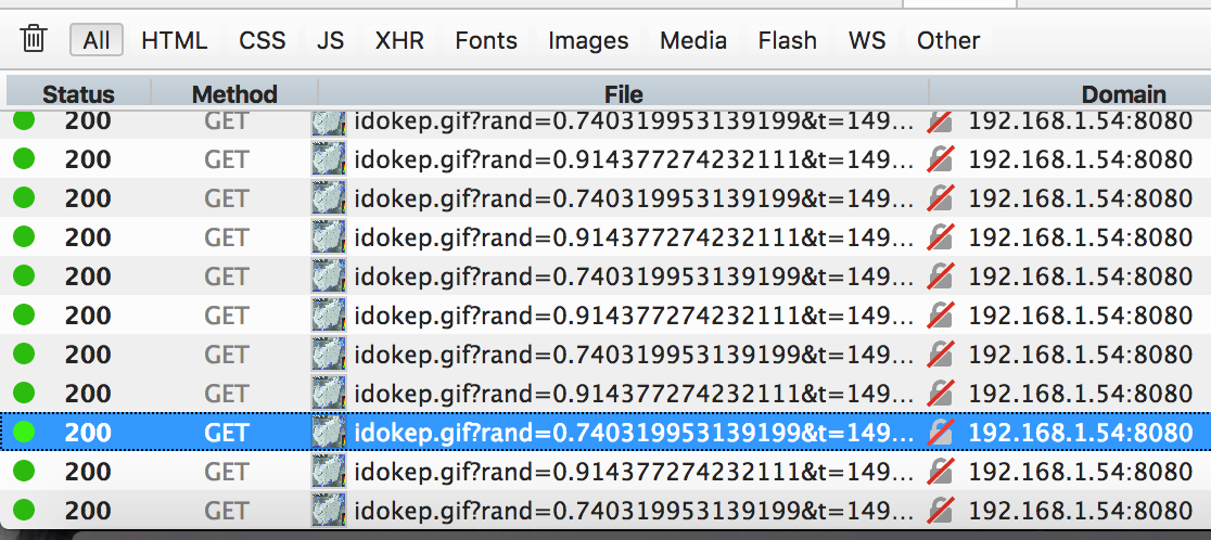

Robert,
For buttons.radar I have a gif file. But it's constantly reloading generating huge traffic.
buttons.radar = {icon: 'fa-cloud', title: 'Radar', url: 'http://192.168.1.54:8080/frontpage/idokep.gif?rand='+ Math.random()}
(math.random part is to prevent caching image).

bierlaagh wrote:Very happy with Dashticz V2.0 Thnx for that!
blocks[2] = {}
blocks['s2'] = {}
Ok, fixed in latest version. (Pushing tomorrow, I think, to gitlab!)
