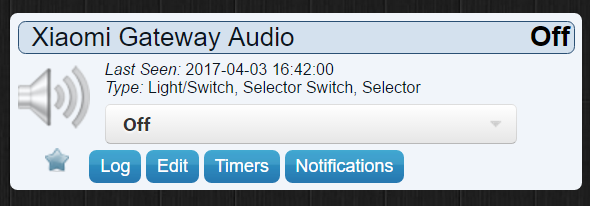

I do not see audio device from gateway.... Pls show screenshot how it looks like. And may be script example - door bell would be nice.
Posted: Monday 03 April 2017 22:28
by deennoo
murtadin wrote:I do not see audio device from gateway.... Pls show screenshot how it looks like. And may be script example - door bell would be nice.
grrrrrr have you read what i write before ? ;-p ?? have you compil from corbin fork ? if not, wait for an update to official beta.
Posted: Monday 03 April 2017 22:32
by murtadin
Of course i compiled from Corbin's fork )). I see lux device, but audio nope.
Sent from my MI MAX using Tapatalk
Posted: Monday 03 April 2017 22:39
by deennoo
i did it this morning and i got it...pic join just before.
Have you git pull your copy of corbin fork and recompil it ? this have to be done each time after an update on his fork.
Xiaomi Gateway Audio is the name of the device discover
Posted: Monday 03 April 2017 22:42
by murtadin
I just updated few hours ago. No luck.
